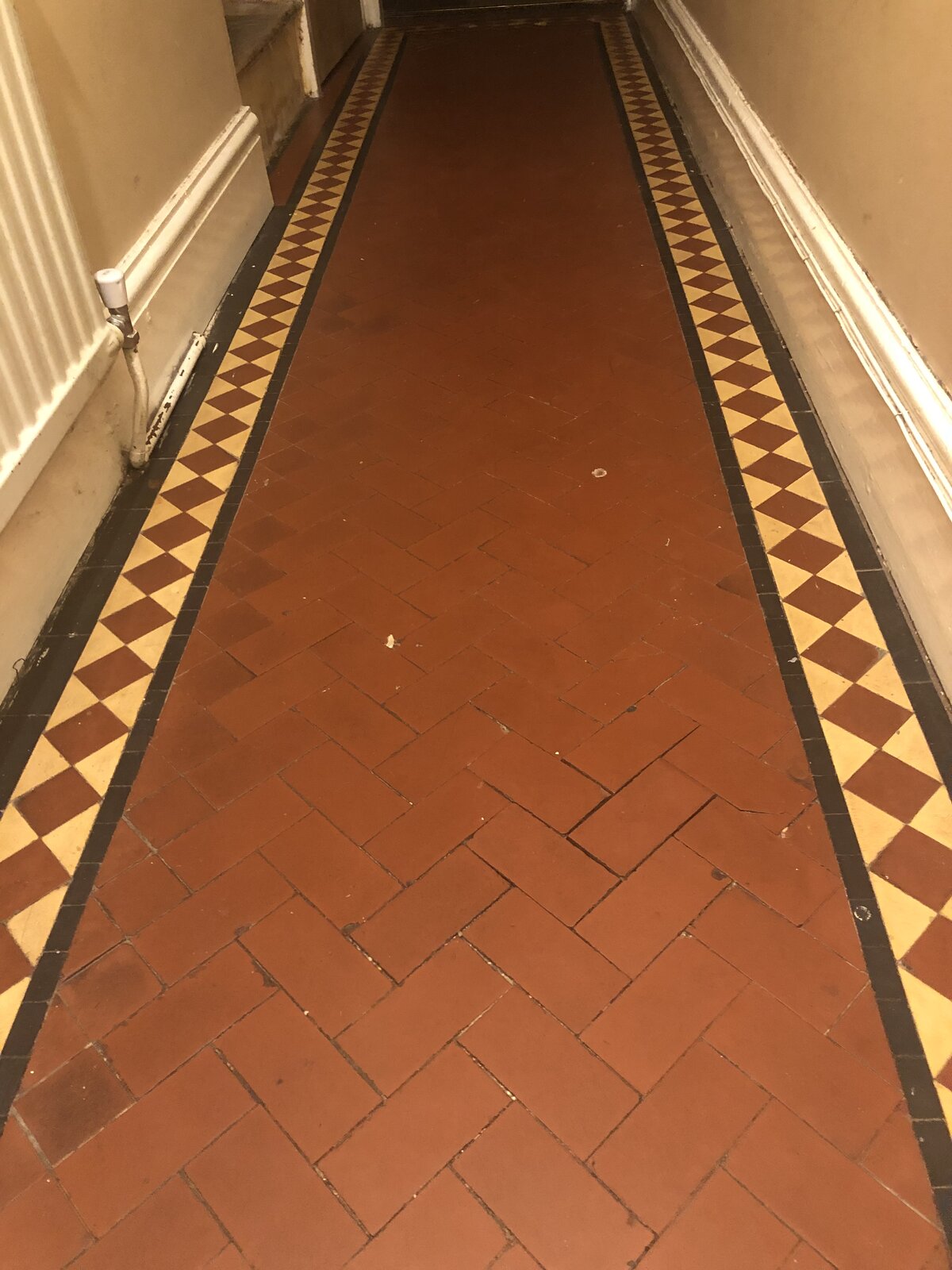

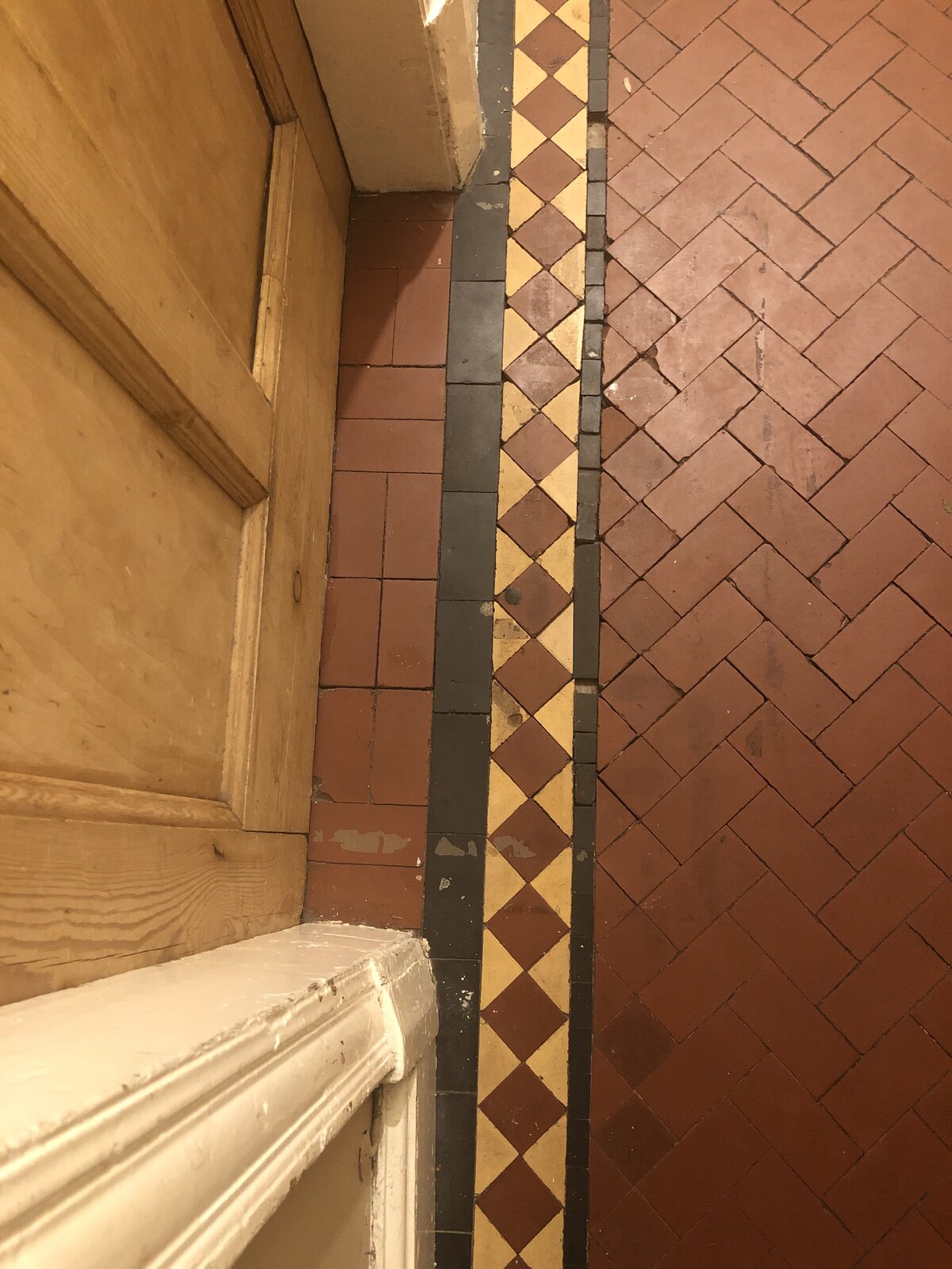

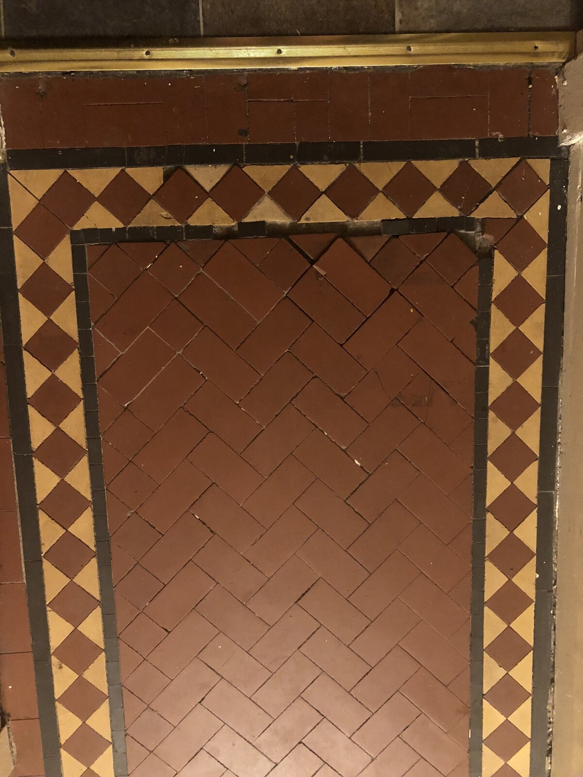

How difficult would this be to restore myself and how would I go about it? Sections of tiles are loose, some are missing and others are chipped. Where can I source original replacements? There is adhesive on many of the loose tiles. Would I be able to angle grind this off? I was thinking of attempting to fix the tiles myself and then pay for it to be cleaned and sealed. I did get a quote from a specialist but it was far more than I was expecting. Any help and advice appreciated.

I would think this is well within capabilities of DIY.
You should be able to re lay these tiles with tile adhesive, although these might have been laid on a sand/cement/lime bed.
A dilute application of brick acid may make a difference and remove some ingrained grime.
If you grouted with terracotta grout this will make small nicks/chips harder to see.
I rennovated a herringbone brick floor, with some quarry tiles inset using the above, it looked good to me, but I'm no specialist.
Good luck

That doesn’t too damaged to me, so a DIY job sounds possible.
I am no expert but if it was me I’d have a go.
There are specialists and reclaim yards who might hold stock of original tiles, make sure that the colour is as close as you can get.
if it’s simply a H&S issue then taping a few sheets of proplex type material would be a quick cover temporarily (and look naff)
not sure if an angle grinder is the best idea, you might find the cement softens if the loose tiles are soaked in a bucket?
