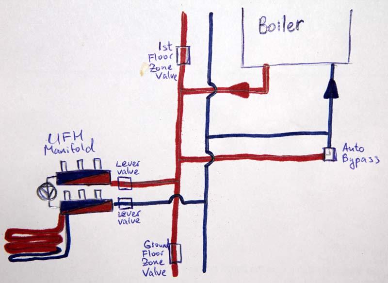

Ok, I had another plumber over, and he thinks that the problem may lie in the incorrect positioning of the bypass valve resulting in the boiler pumping against itself if only 1st floor circuit is open. I drew a scheme of the boiler connections. Can anybody point out what's wrong with it?
