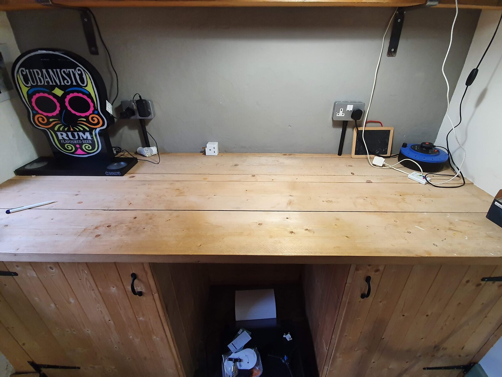

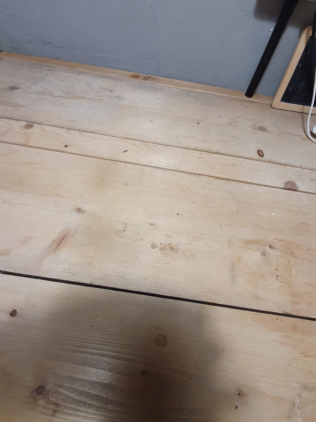

I inherited an outbuilding with a fairly cheap and shoddy desk which I've put up with until now.
I'm using it now as an office but it's morphing into more of a man cave/bar type affair. I'd like a smoother finish to the desk (you can see the rough pine & gaps in the photos). What would be the easiest option for someone with limited DIY skills? I was thinking of some thin MDF over the top else replace all the boards with gaps between them and fit a single piece of MDF.

You will probably find that if you attempt to glue another later onto the desk, such as hardboard, MDF or thin plywood, that the entire desk top will start to curl up in due course. Our forebears (and even my mum) used to cover old tables with table cloths or oil cloths, which may work for you. Alternatively what about sanding the top, sealing with a couple of coats of clear semi-matt lacquer, then filling the gaps between with clear silicon sealant, smoothed off carefully with a "silicon finger"?

Thanks, that's a great idea - sanding smooth then sealing - maybe some kind of varnish even. Is there a sealant for the gaps that dries to a hard finish unlike bathroom sealant?
Single sheet 18mm Mdf , get it cut for you, very easy fix and a coat of danish oil will seal.
The problem is that timber moves, so if you do put a hard sealant in between two pieces of timber (which may or probably won't be well fixed together) it will almost invariably crack at some point or another
If you glue it you run the risk of it curling upwards (like I said before). Screw it down, or better still screw it from the underside. Just check your screw lengths carefully - you don't want the points piercing the surface
