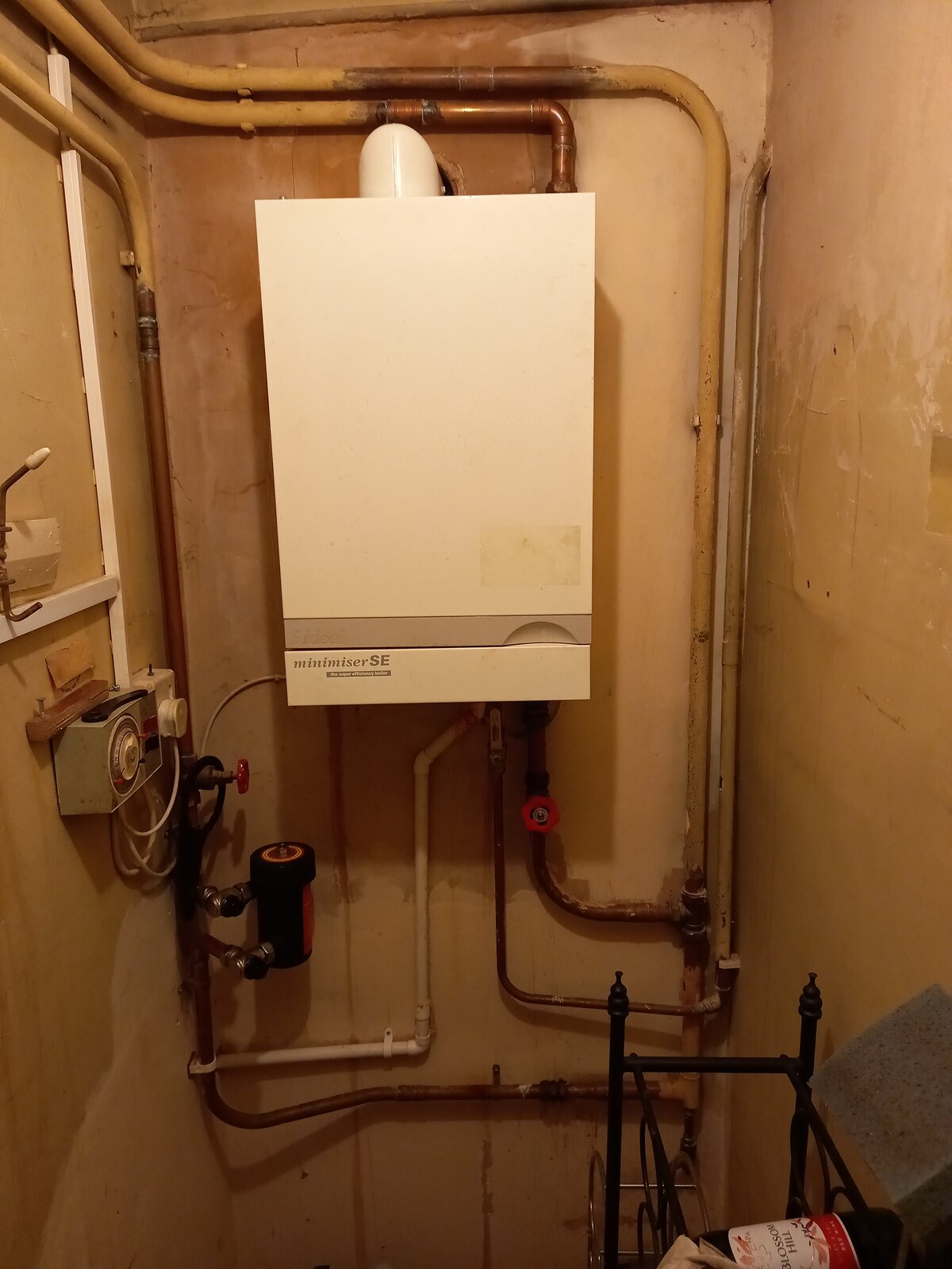

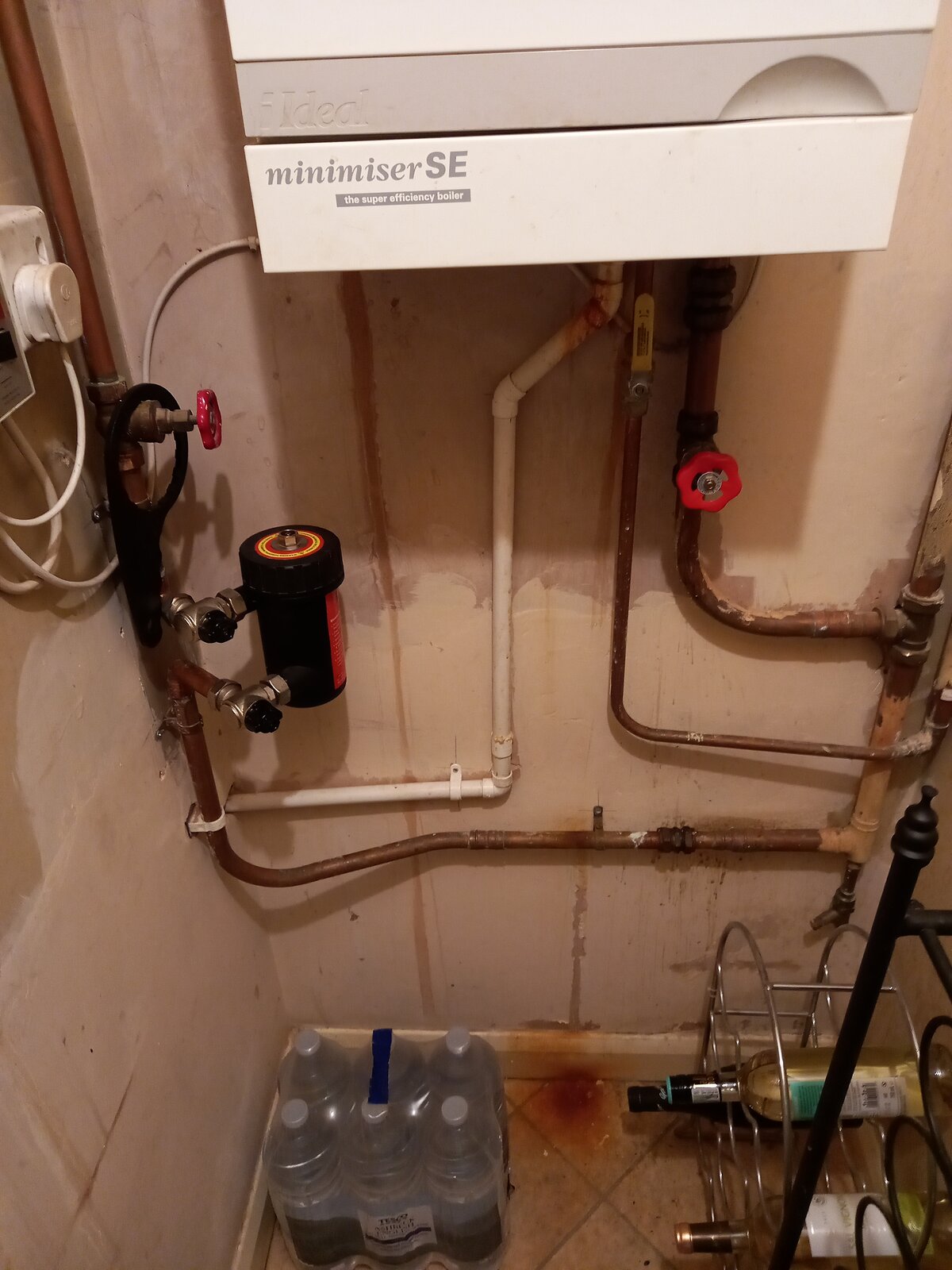

Can you post a photo? Usually the connections are remote from the boiler, into one common return pipe. If it's any help, a couple of pics of my boiler. The 22mm pipe to the left is the rads return, up and downstairs commoned further back. The cylinder return is the top 28mm pipe. Boiler flow top, return bottom. It's a conversion from a gravity HW system, hence the 28mm pipes.

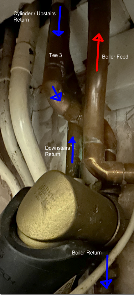

This is tee 3 at the top of the boiler, 22mm coming through the ceiling is the combined cylinder and upstairs return from tee 1, at this point we are about 4m downstream of the cylinder.
Tee 3 centre joins this with the 22mm return from the downstairs rads and the bottom of the tee goes into the the boiler return via the Spirotrap.
Boiler feed - is that the boiler flow?
Is that the pump - pumped return system? Never seen one like that but I'm just a DIYer. Or some sort of filter?
A pic showing more of the surroundings would help. If there's room maybe the up and downstairs returns could be commoned some distance away, giving room to tee in the cylinder return before the pump.
Looks like a 45° elbow after Tee 3. Is it possible to change to a 90° and connect to a tee on the pump inlet, with the cylinder return into the tee? Or is what looks like blockwork in the way? Fiddly job and need to remove temporarily the "boiler feed" pipe to do it.
