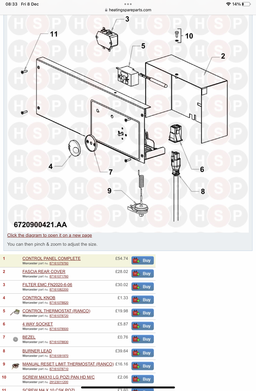

Hello. Burner immediately trips the rccb when call for heat is initiated. Circulation pump and other wet side components are not causing this as work fine when boiler power is off. An earth leak in the burner but any ideas how I find out what exactly, or what is most likely to cause this. Boiler was also locking regularly recently - seemingly when hot, but now simply trips the rccb.Thanks.
RDB burner then, At which part of the ignition cycle does it trip?
Unplug the burner from the control panel to check if wiring or burner fault.
That’s it. The last time I tried the motor/fan was spinning for a few seconds and then it tripped.
How many is a few seconds? If it is normal prepurge, then solenoid coil could be suspect, but at the same time, the spark is also generated, so it could be either, coil or control box.
Thanks. Just tried it and still tripped so not the burner after all. Also without the noise I could hear crackling behind panel in the picture before it tripped and smell burning. Appreciate your help.

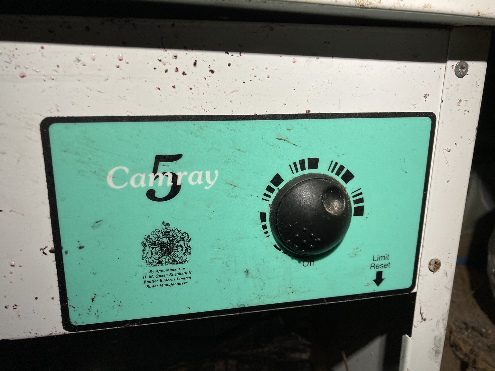

No, not tripped the rccb before, but has locked out a few times over last few months. Heating circuit goes through a type 1 mcb, but this doesn’t trip, only the main consumer unit rcd immediately after call for heat. Not certain but I think this means an earth leak is responsible. Earlier reply suggested unplugging the burner to eliminate this. I did this and it still tripped and I could hear crackling and smell burning behind the main control panel, so must be one of the components pictured. I’ll have a closer look later today.
