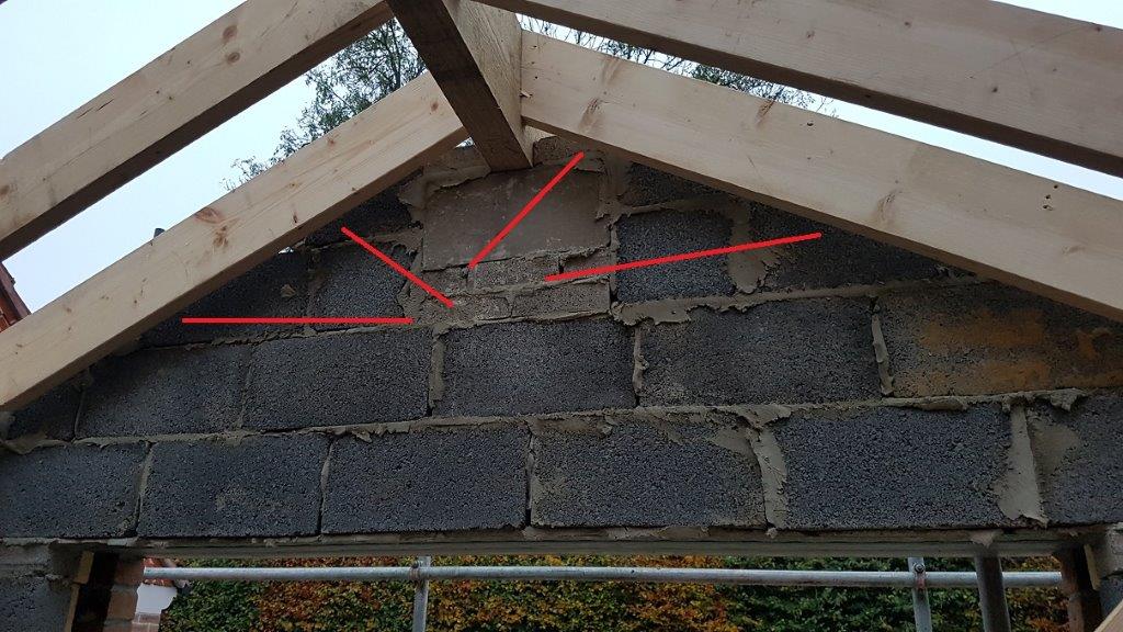

ok i'll seal it tight... one question. where the last rafter is close to the wall there is a 50mm gap - what should i do here? try squeeze a sliver in? or use some expanding gap filler.. or something else?

I'd use expanding foam, but the trick will be to keep it in there while it goes off - try to make a former that you can seal up as you go along - out of something like gaffer tape or thin cardboard.
would it matter if the gap was completely filled? or does this section also need the same 50mm air gap above it.
I wouldn't lose sleep over filling it up, and if it's that well sealed with expanding foam then it shouldn't be possible for too much vapour to get in there to condense anyway. Are you foil taping over your PIR panels? I'm a bit OCD in that respect and would pay particular attention to the detail around there but that's just me.
yes I am going to foil tape over the panels, I will cut back the expanding foam flush and tape it to death!
