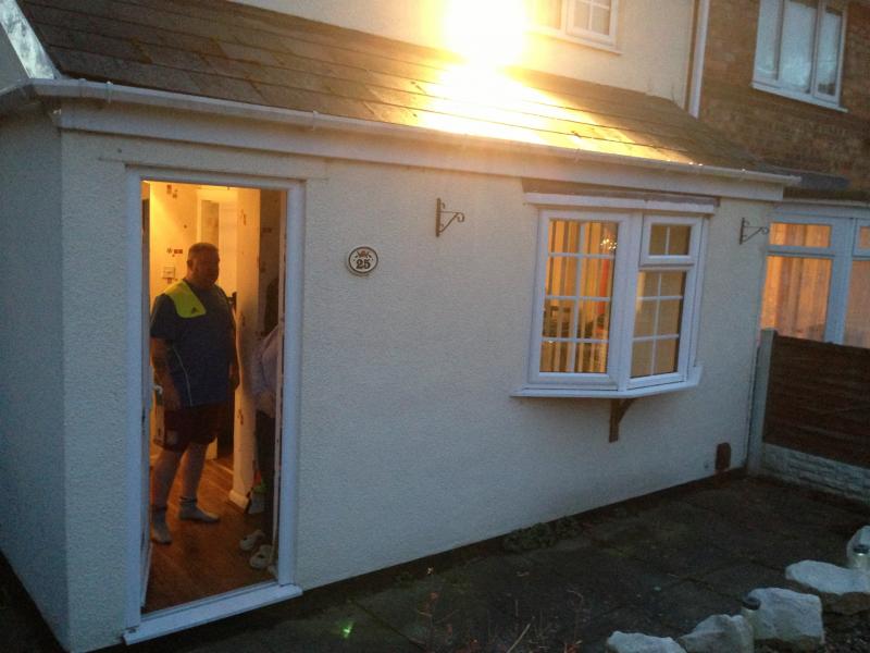

BTW what are those things in front of the wall?

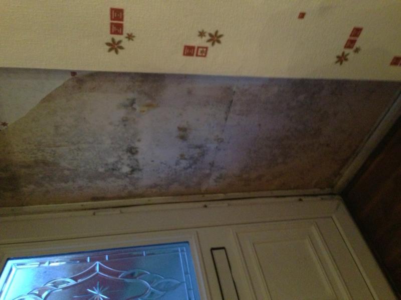

Thanks for the pics they are helpful.

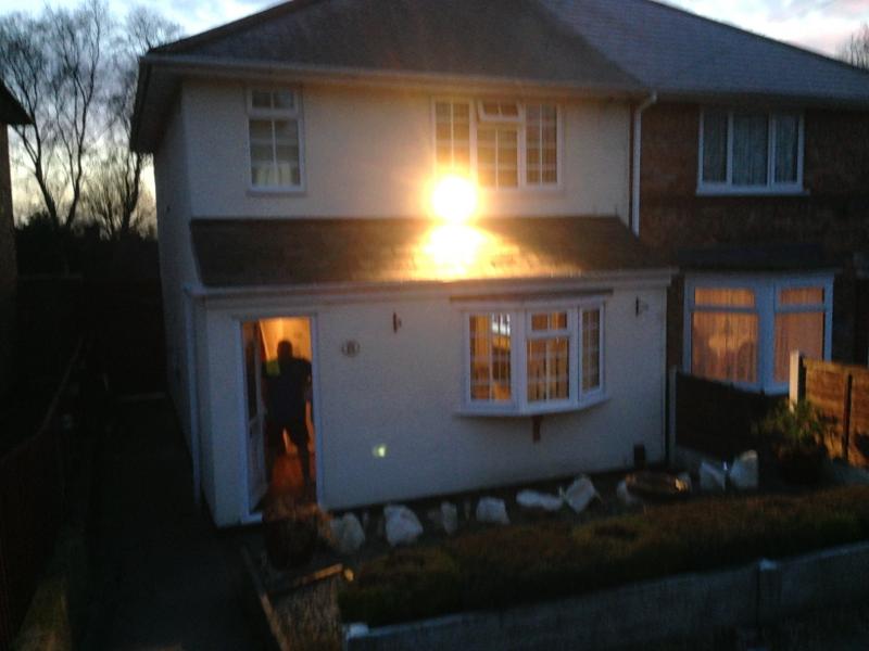

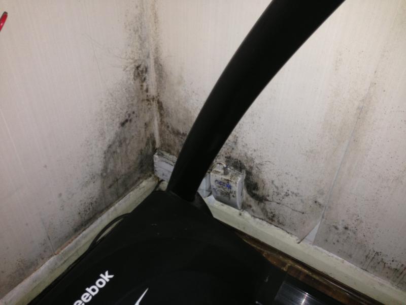

Are you saying that there is damp at each corner of the porch extension floor pics 2. & 4. and up the gable wall by the front door pic 3.

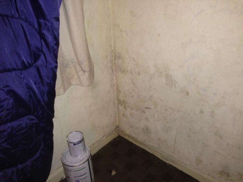

You next mention damp in the bedrooms - directly above? Pics please.
Have you carefully examined the whole of that gable wall for any similar stains, upstairs & down, pulling furniture away from near the wall?

I think there is a rainwater downpipe outside the wet wall in picture 3, and some sort of flashing suggesting a troublesome verge.

There are two external photos, the rest are internal
