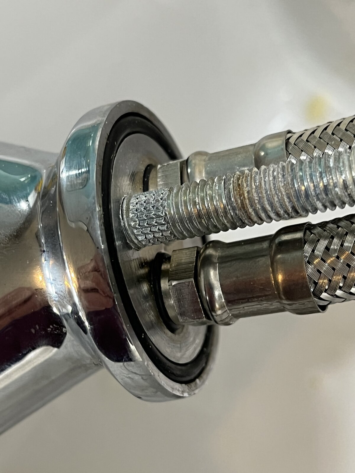

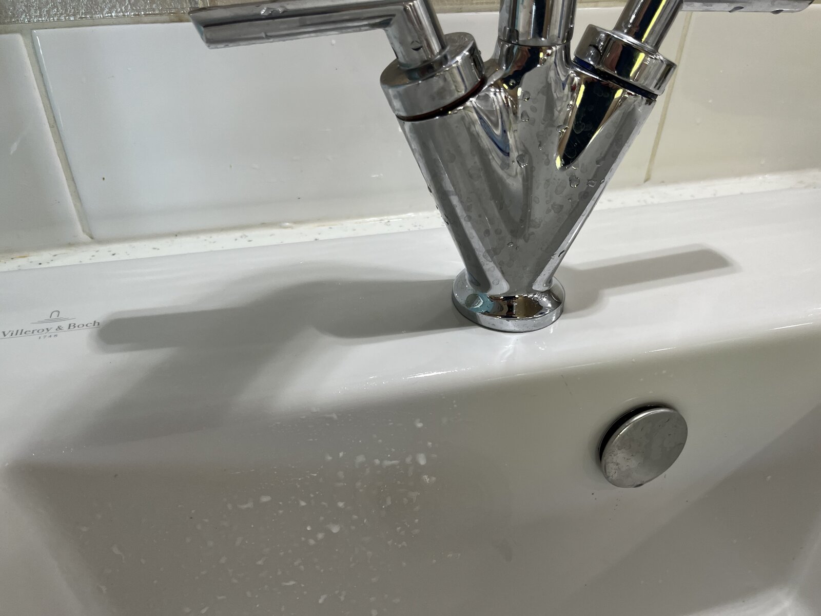

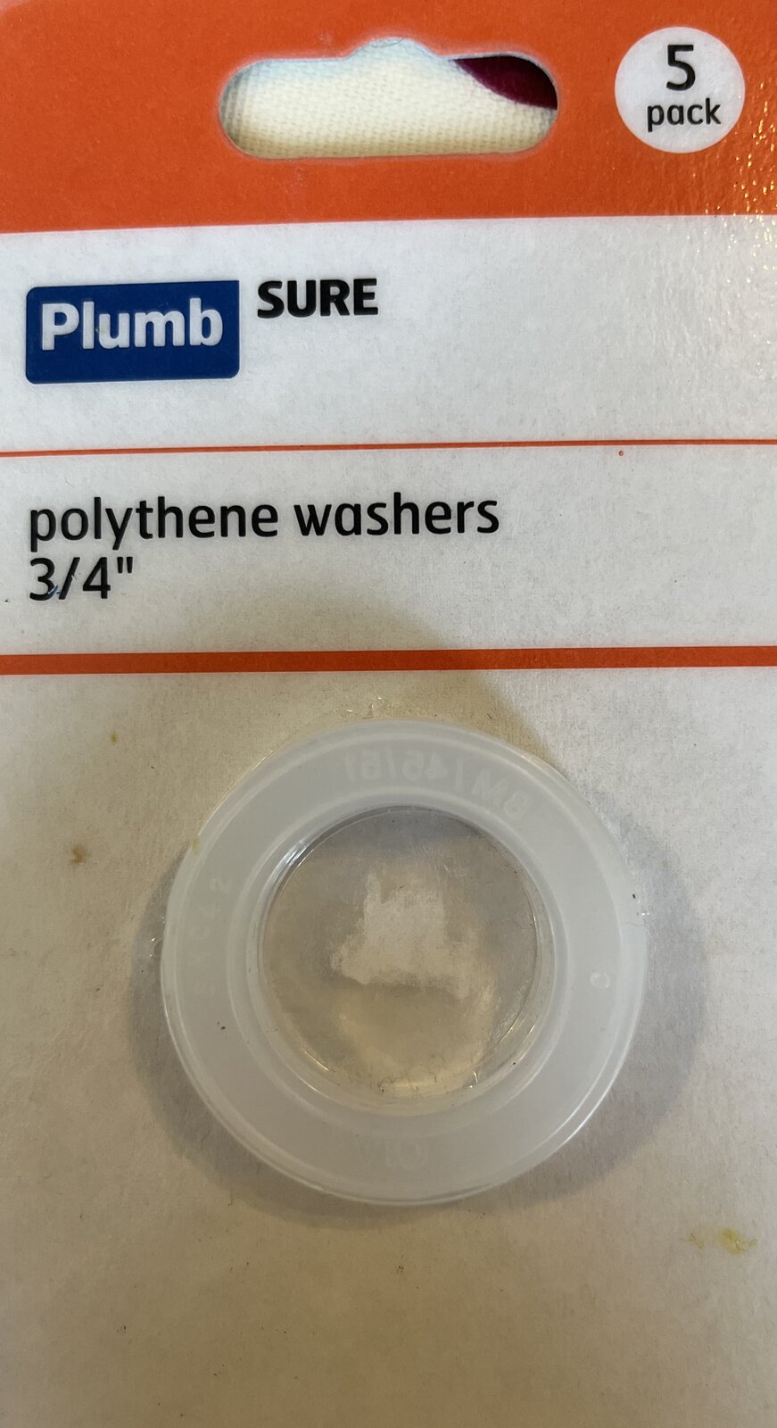

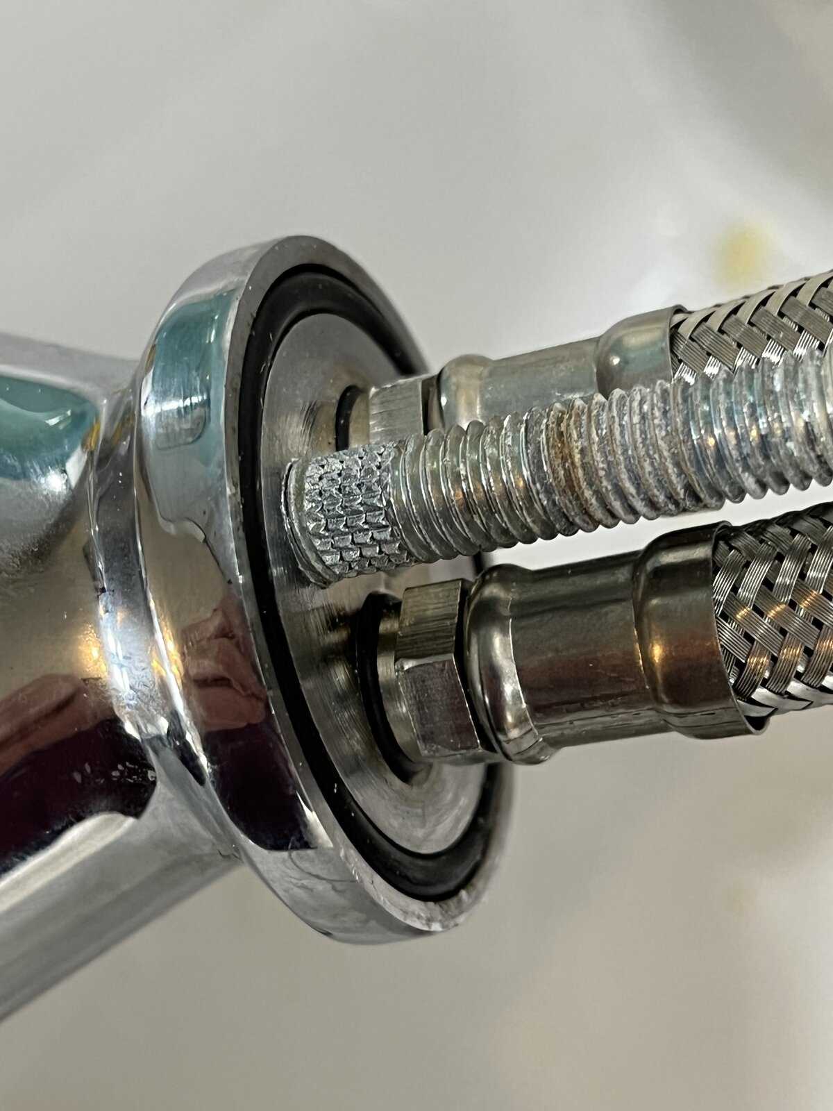

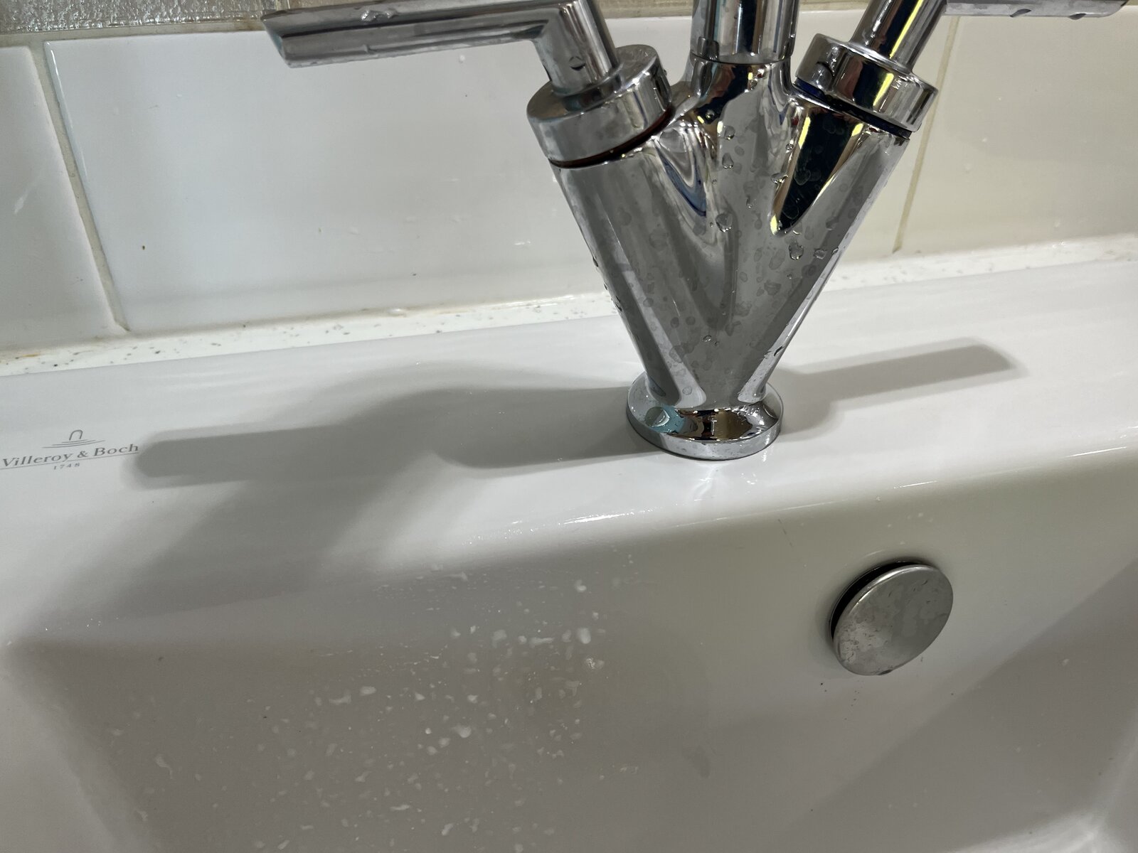

We’ve got some nice ceramic kitchen sinks and we’re nervous about cracking them by fixing on the mixer taps. The taps have black plastic seals underneath them (see pic) which would be in contact with the top of the sinks when attached. We wonder whether we need additional washers such as polythene washers between the tap and sink top (see pic) to protect the ceramic sink?

1. You shouldn't need anything else under the black rubber seal. This seal compresses slightly on tightening to:
1a. Stop water going under the body of the tap. Introducing another washer might interfere with this function.
1b. Prevent the tap from rotating. Again, another washer, particularly a non-rubber one, might stop this working.
2. Tightening the tap has the basin in compression, and its much less likely to crack in this way.
Make sure the seal in the tap base and the basin are squeaky clean and dry. Shouldn't need to overtighen the tap down, just till it grips and doesn't move/spin.
As others have said, you don't need anything else.
If you used the polythene washers, the seal between the base of the tap and washer would be fine, but you would be likely to leaks between the washer and sink.
Generally, one uses a box spanner to tighten the retaining nut on the tap. The "tommy" bars to tighten the box spanners are unlikely to be long enough to provide enough torque to damage the ceramic finish.

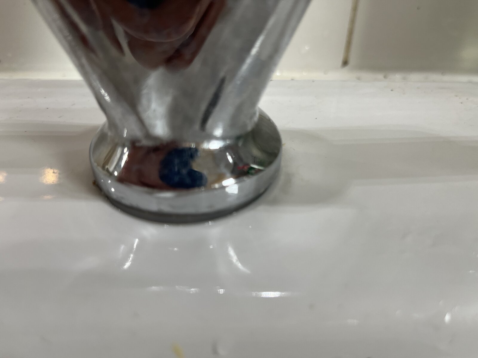

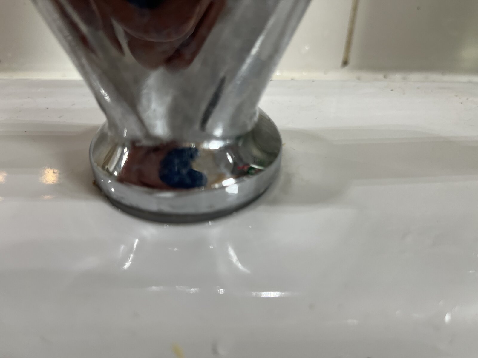

Perfect example...
Clearly the washers are proud
what would you have done different here?

Something like this would have an O ring seal on the shroud. But this would be obvious to any monkey the the O ring has a place to go
Perfect example...
Not the op's case.
Those contractors taps are meant to have a visible rubber, unlike the op's tap which has a o-ring sitting in a groove as you rightly pointed out.
Removing that o-ring or fitting it incorrectly will result in water dripping under the sink.
That o-ring is there to stay and doesn't need any sealant.
Not the op's case.
Your correct I should have been more observant..
