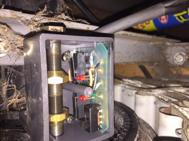

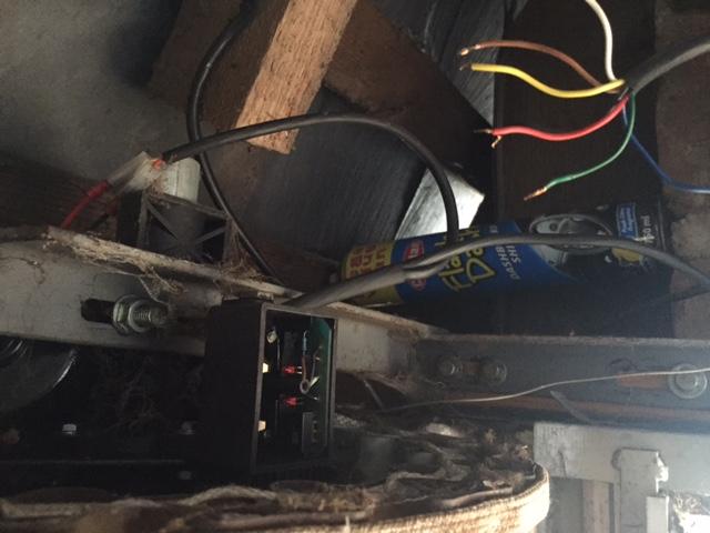

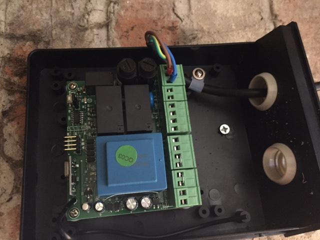

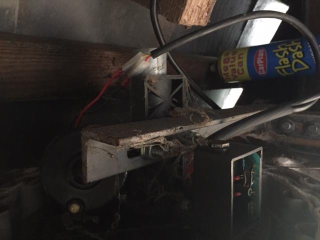

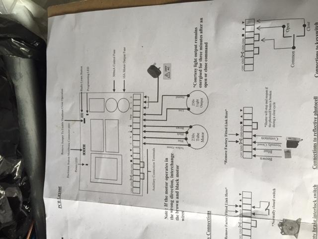

Hi, hoping someone can help me please. Have purchased a new control unit for our roller shutter. The new wiring diagram shows 5 cables coming from the motor but I have 6. Coming from the current control switch and motor are free,blue,red,yellow,brown,white. it looks like the yellow and red are connected directly to the motor and all other cores apart from the blue are going into some sort of control switch. There is no indication on any of the parts as to what each core/colour does. I have attached photos of the current control switch & motor along with the new control board and wiring diagram. Any help gratefully received. Thanks.

Pictures 1,2 and 3 seem to show a limit switch box.
Picture 4 shows a control box.
Picture 5 the wiring diagram.
The picture 4 and 5 match but pictures 1,2, and 3 do not seem to match anything shown with 4 and 5.

It would seem the control box is not designed for your door. But to be frank can hardly read the PCB Layout just not good enough but giving what I can read in case some one else can help.
Hi thanks for the reply.
Yes pictures 1-3 are the existing motor and switch. Pics 4 & 5 are the new control board and wiring diagram. Don't think the wiring diagram will be too much use but hoping someone will have an idea as to how it could be wired. As I'm thinking essentially the old box would send a signal to open & close same as the new control box but with limit switch switching the motor
