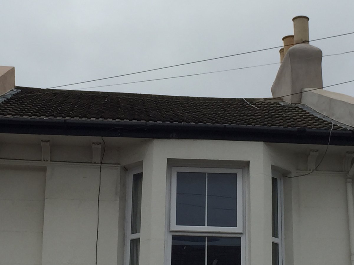

Our roof is level across the peak of the roof but does sag a little I think (it's every so slight) in the middle of the main flat bit.

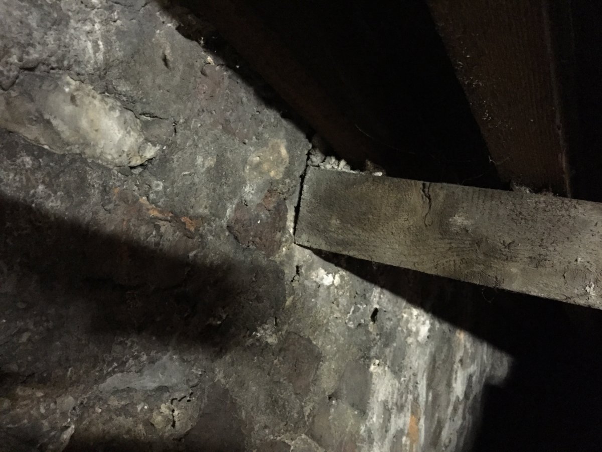

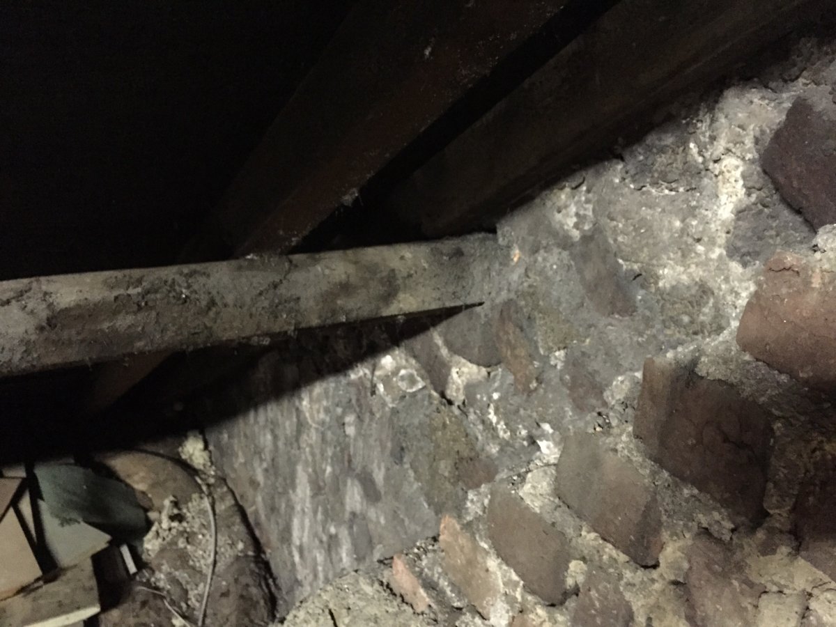

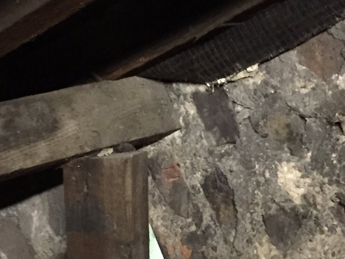

Upon inspection of the loft there is 1 purlin on each side (approx 1/3 of the way up) of the roof but only 1 of the 4 ends seems to go into the gable walls.

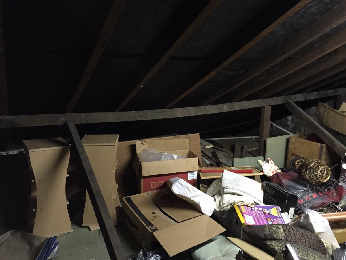

Each purlin is supported by several vertical struts from the loft floor. Each purlin also has 2 angled beams supporting from the centre of the house.
My question is can I support the purlins further without replacing them as they are not long enough to go into the walls at each end?
We definitely need pics of the inside of the loft and the "little sag".

I see only two vertical posts - what are these posts, and any other posts supported by? They should push off masonry walls.
There's no context or indication as to where in the loft the pics are pointing?
Are the rafters still securely nailed to the ridge board? Simpson LRU hangers, or L straps, would strengthen the connections at the ridge.
Hold down plates could be used at the wall plate to connect the rafter, and long screws thro the joist and rafter would create a truss effect.
A right angled drill would be needed.
The length of purlin in the pic 139.4KB shows a purlin too lightweight to span and support the rafters/roof. More posts fixed to the purlin would relieve the weight. Fixed with Simpson connectors/plates.
The rafters should be fixed to the purlin.
If your roof spreads or the ridge wobbles then the present set-up wont hold.

The 2 posts are sitting on some wooden lengths that are running across the joists. These wooden lengths are not above any walls or supporting part of the structure.
The posts are at (and towards) one end of the purlin that does not go into the wall at either end. This is also the purlin that is bowed in the 139.4kb pic.
The opposite purlin (not pictured) goes into the wall at one end and not at the other. This side has no posts and is simply held by the wall at one end and then by the 'angled' beams which are also on the first side (139'.4kb pic). It is also the same lightweight dimensions.

If I were to fix 2x4 across the width of the house vertically under the purlins and then put vertical posts up to the purlins (with right angled cut outs in the top for the purlin to rest in) would this provide any meaningful support if the 2x4's are spanning the joists but are not above a supporting wall?

Leave the purlins/2" x 4" notions to one side for now.
The wooden lengths that run across the joists are plates and you could double up the plates and pack them if/where they cross any walls.
Then secure and notch or mitre the posts to the purlins, & set them on the plates - you will have to do this for the purlins both sides.
So its plates, posts and secure connections.
Bolting end posts to the party walls would help.
Bolting collar ties from front to rear rafters would also help prevent spread.
