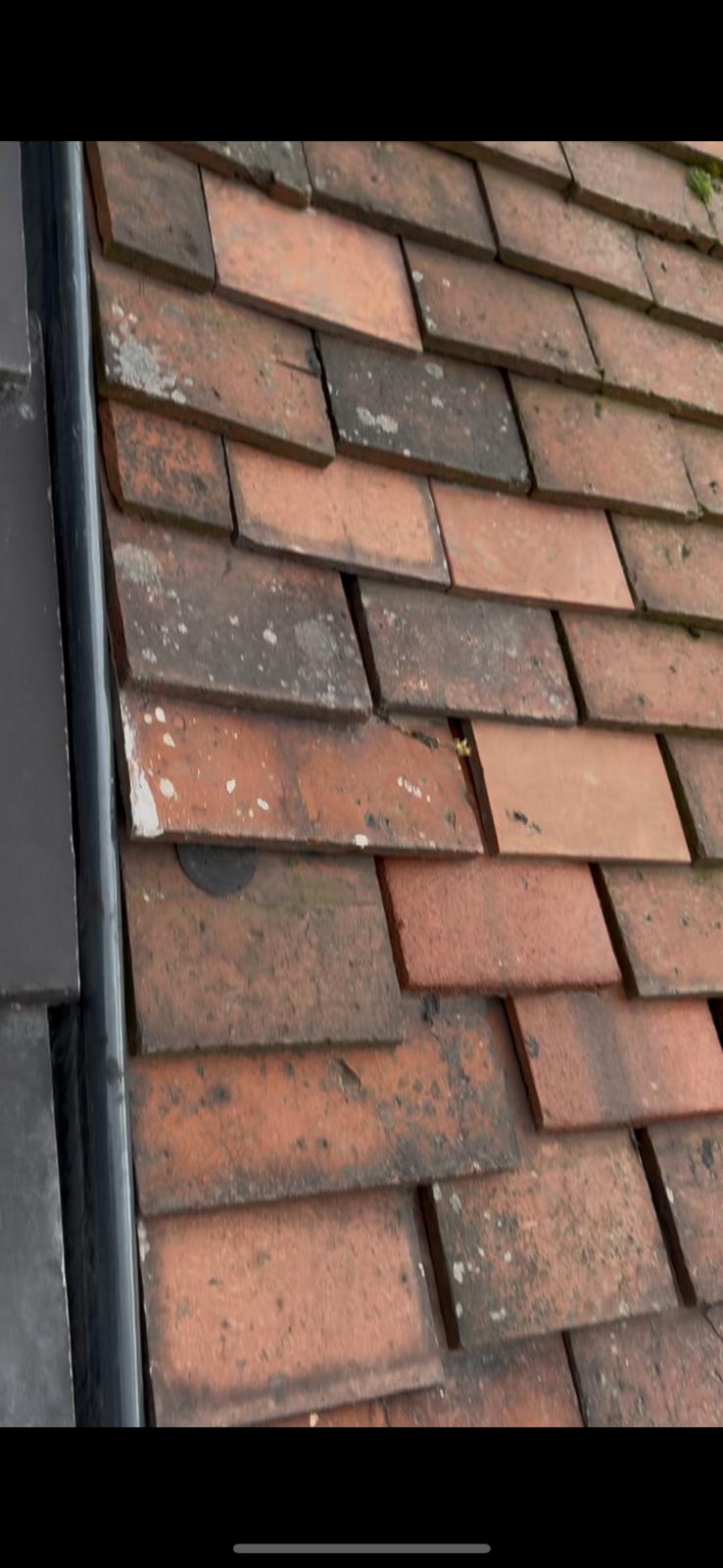

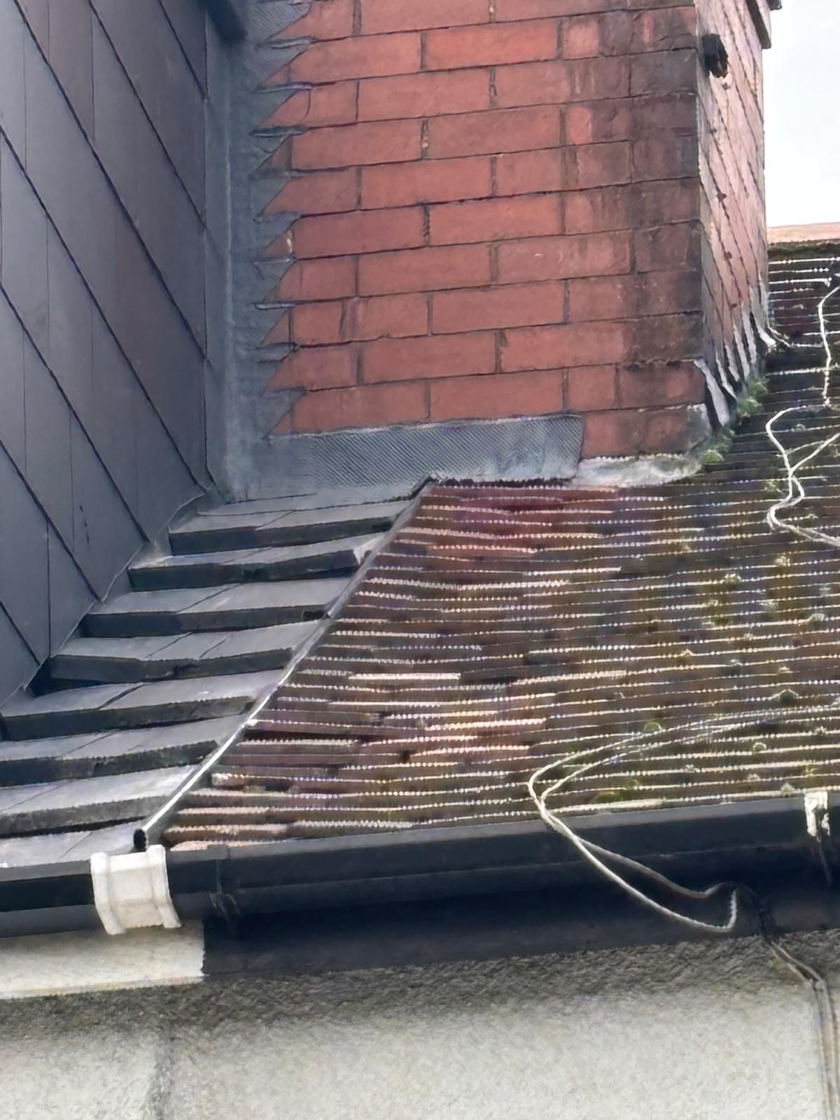

Hi there,
My neighbour has done loft conversation and now I have a leakage in my rear side of the house where I can see the joining of old and new roof tiles is in my area
although from the chimney to the front joining is at the centre
but the back from the chimney is around 6 inches inside in my area from the main wall. I have confirmed it by accessing my loft. From the attached pics you can clearly figure out. I believe the leakage is due to the joining and it should be at the middle of the wall.
Please advise, how I can resolve it?
Many thanks

it looks to me like theyve kicked all your tiles up -I wonder if the bonding gutter is sitting correctly and tile battens etc altered to suit it
is it actually lead flashing theyve used on the new roof to the chimney -looks a bit strange and very messy on the non dormer side

Go up into your loft again & look up at the party wall roof join - there might be an indication of how in pic #1 they've crossed the party wall & possibly skipped the needed fire blocking at party walls?
Perhaps the rear bonding gutter is sitting on a joist instead of the party wall?
The battens on both roof planes look to be wrongly installed - & if the battens are wrong then the roof felt/membrane has possibly also been installed wrong? Badly installed felt is possibly the cause of your leak?
FWIW: these matters can get pretty complicated because they will most probably involve the Party Wall Act
& various specialists.

your tiles are kicked up because he hasnt fitted the bonding gutter / flashing properly and now youve got a leak
its not possible to know what theyve done wrong from the pics -maybe an inside picture might help, but the outside images do show that it has been done incorrectly -and I have not doubt that the firebreak has not been maintained.

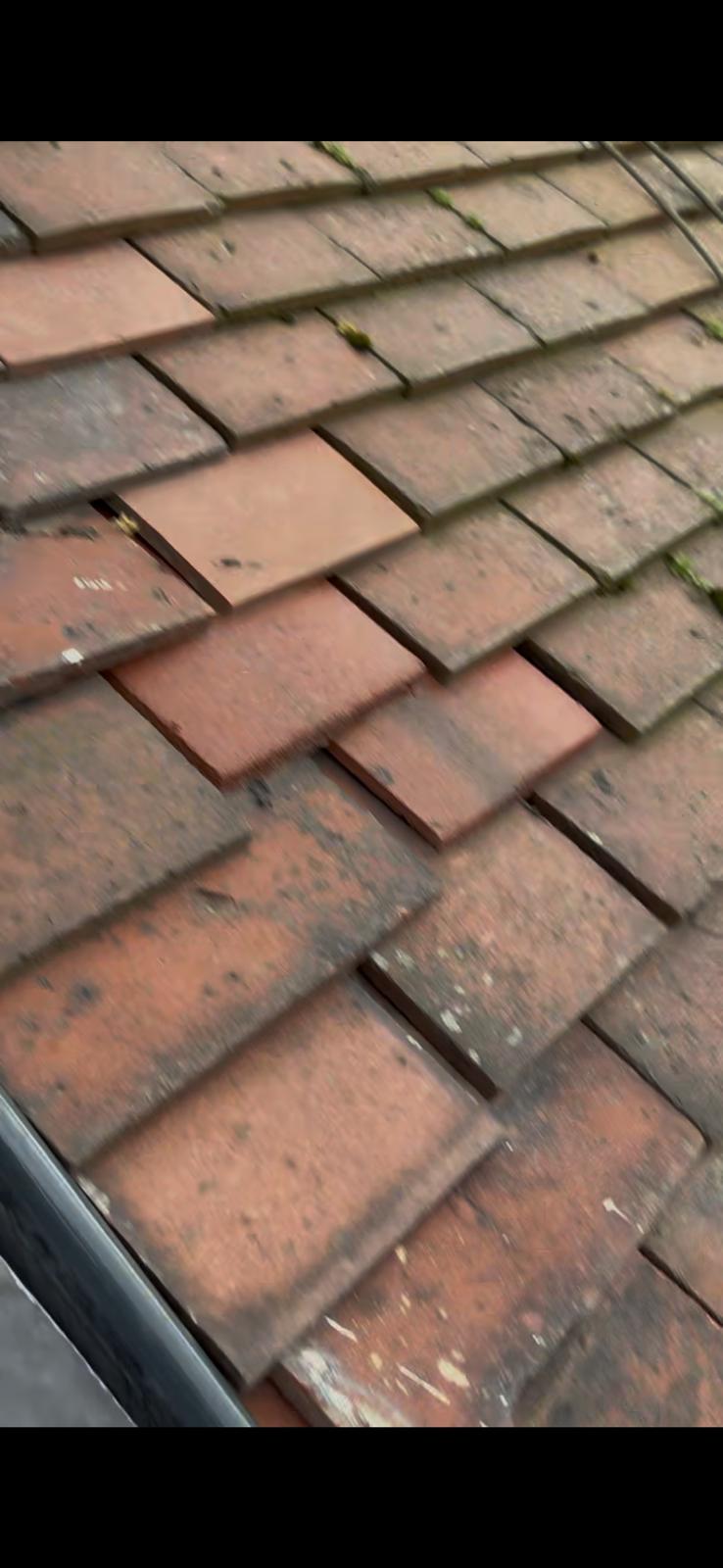

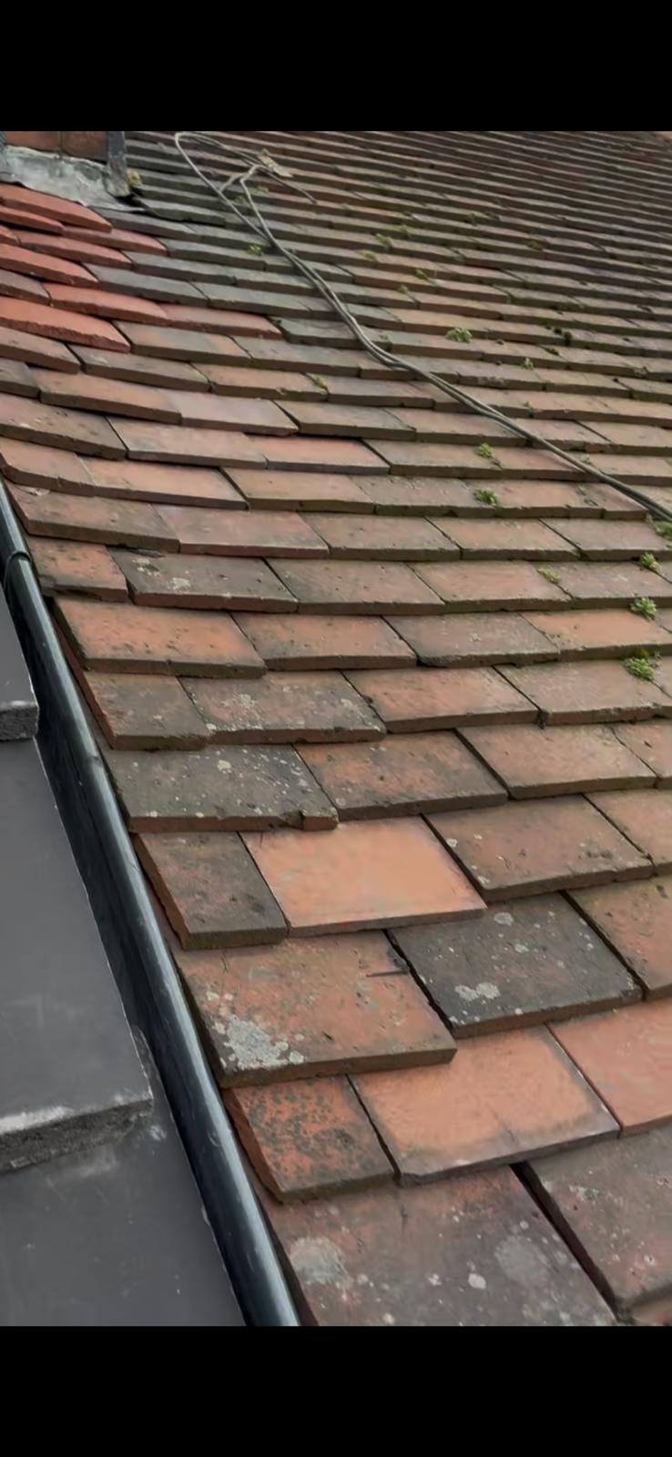

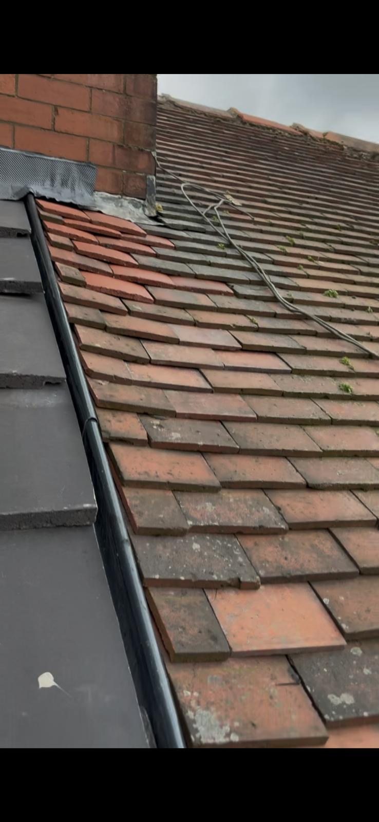

@Notch7 @Alastairreid @diy_fun_uk thanks to you guys so far for your support. Finally my neighbour put the partition in the centre and can not see the leakage yet although have to see with more rain but looks fine so far. The concern I have now is if they have laid down the tiles correctly or not because from visually I can see gaps and not levelled, please see the screenshots. Can you guys please give me your opinions?
