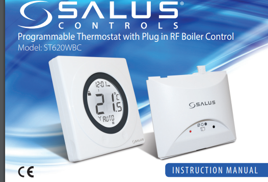

Hi, I have a Salus ST620 thermostat attached to a Worcester boiler that’s not working properly and I would rather have a remote controlled thermostat. would it be on the same rf frequency with the RT3101 if I changed it? And if not, what model would work? Thanks in advance.

The thermostat is wall hung in another room from the boiler. All the troubleshooting checks were done but neither light, touchscreen or pushing the ok and arrow buttons work. I have managed to get it paired so at least some heat is on but the programme is stuck to the last person's setting and of course the time is an hour out. changing the batteries didnt do anything. Im wondering whether someone has damaged something inside as the screw to keep it connected to the back is missing.
The property is a holiday let. I just want to get a thermostat that will work and that I can control remotely. Tech advise is going over my head so I just want some advise as to which thermostat will work remotely and is compatible. The flat is on one level in a grade 2 listed building it gets very cold in there and the internal walls are brick.
Is this what you currently have? With the receiver on the right attached to the boiler?
If so, this may be compatible with your existing receiver. I know nothing about it. This is not a recommendation!
