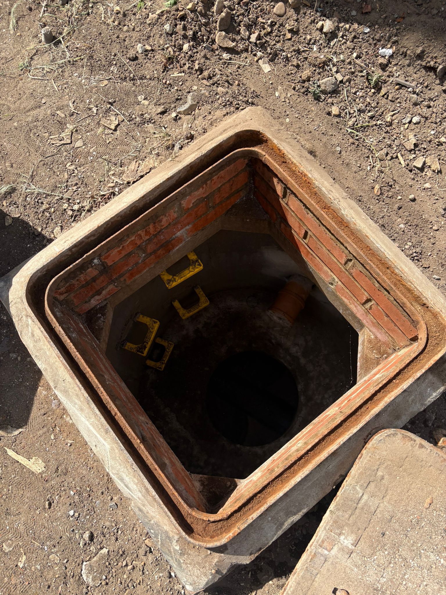

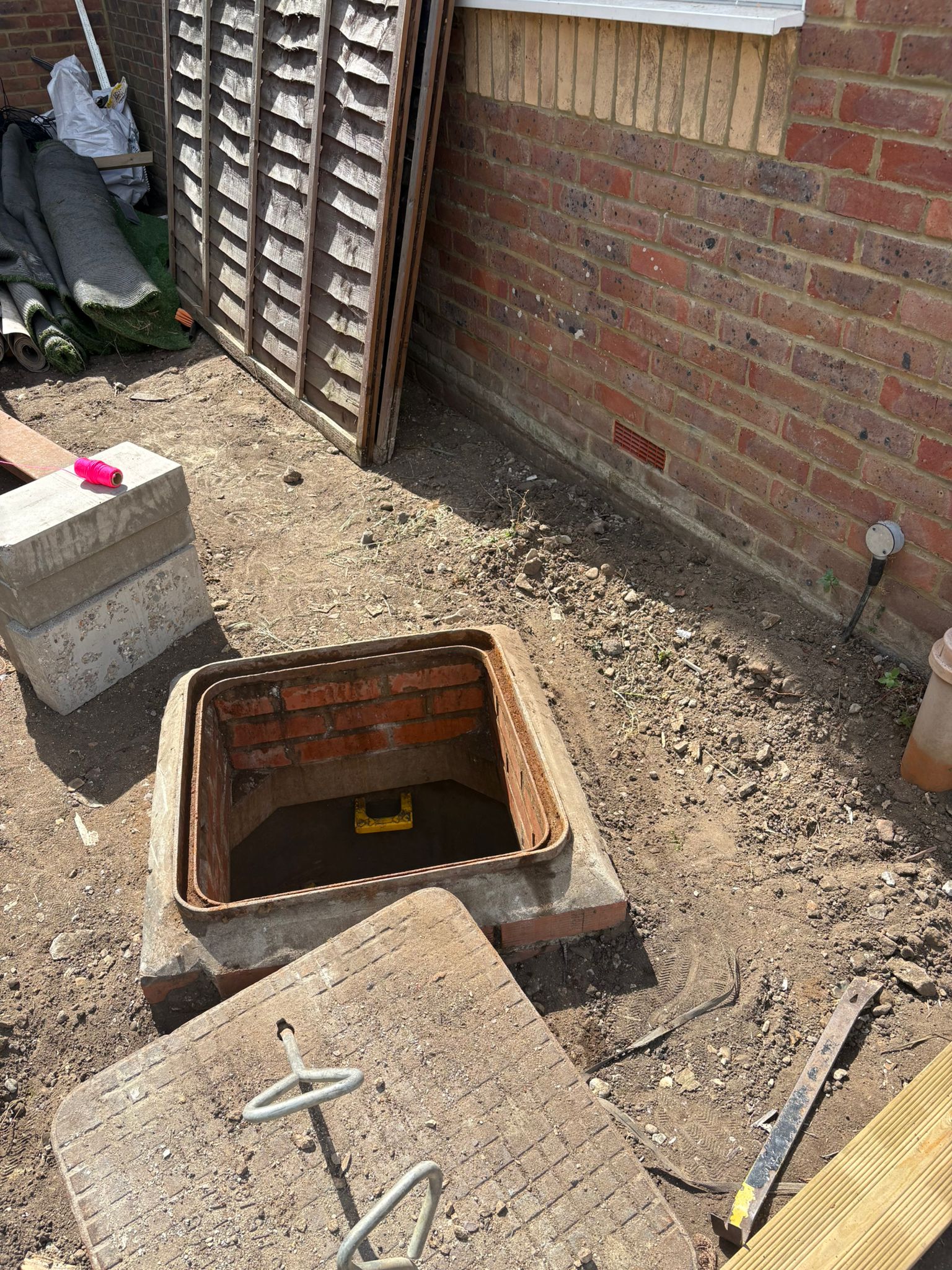

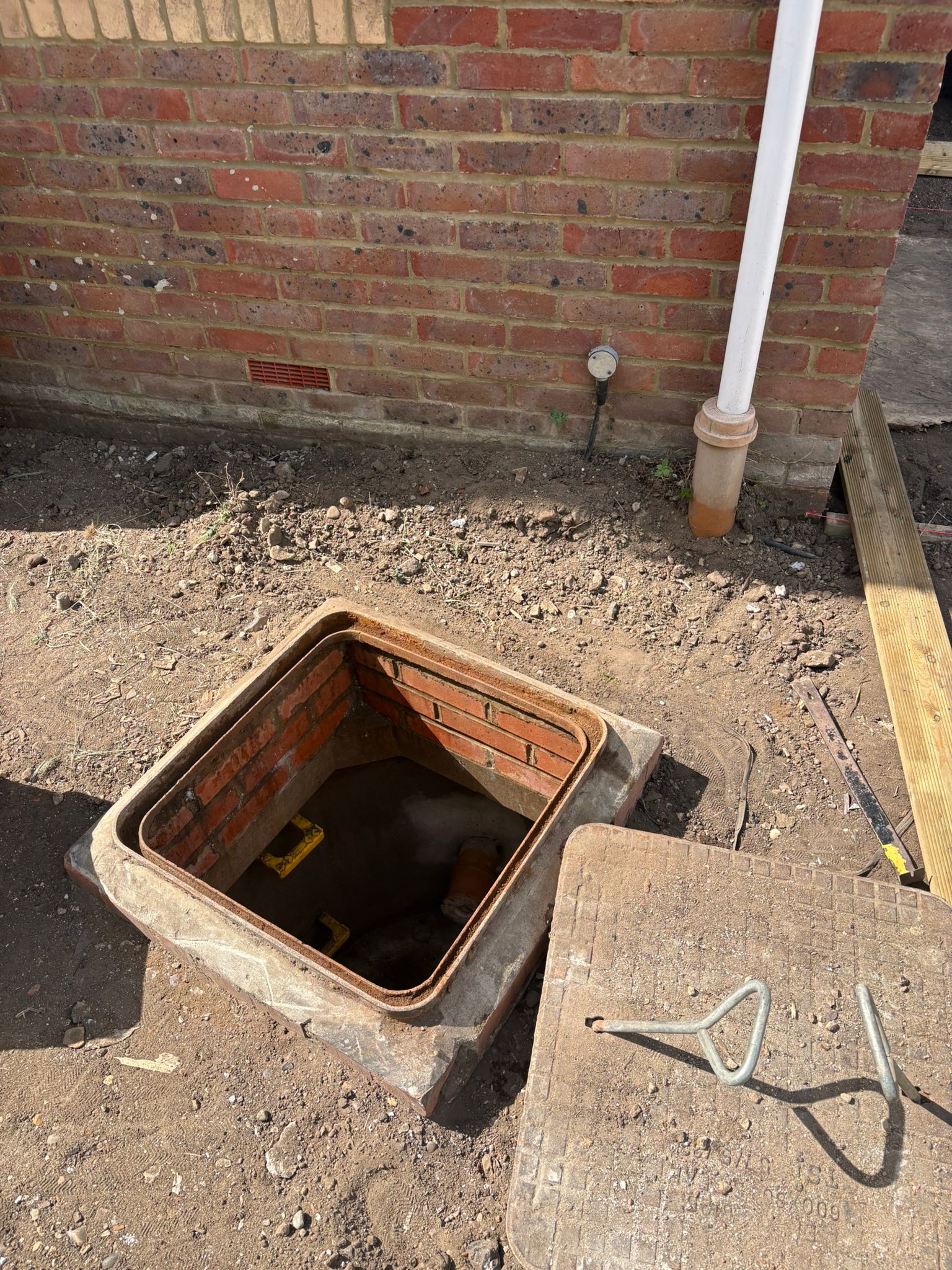

Hi all,
I have a larger deep surface water chamber (I presume that's what it's called) in my back garden. I am getting ready to lay a patio and would like a recessed cover. I would also, ideally, like to install this recessed cover parallel to the house wall for aesthetics.
Can this be done? If so, how? Is it the case of hiring a lifter and rotating the entire chamber cap around, or is there some sort of lintel/concret cap I can install on the existing to allow me to get the new recessed cover to be paralell to the wall?

I am no builder, but that looks like a deep shaft with a top layer that’s been added to the original chamber?
I would GUESS that the top brickworks could be altered to reorientate the top cover.

You don't really want to be messing about with that IC. Anything falling in there and you are toast.
There is a reducing biscuit on top of the larger chamber, that seems to have been placed on top, with little thought (or knowledge) about neighbouring plots

Difficult to tell from the pics but the original yard level seems to have been below the air brick - which suggests that the manhole was higher than its previous surrounding yard level?
Typically, the top of the new recessed frame should be level with the surface of the new patio tiles.
You need to establish a bench mark - & set up lines to the manhole & round the corner of the building.
Take into account that you should stay below the building DPC.

It will belong to a utility company, who will have wayleave rights to enter your garden to access it. This would have all been agreed between them and the housebuilder, before the house was first sold. Your deeds should contain all the details. It's not yours, you're not allowed to touch it.
You mucking about with it would be the equivalent of a farmer getting his spanners onto a pylon in his field, changing its shape to make it prettier.
Put a planter or some gnomes on top if it really offends you.
Fit a recessed cover but cut your blocks so they run the correct way inside the lid and you'll barely notice it's there
You'll really need to get consent to change the cover if it is public (ie shared) though most peeps would do a straight quick switch of covers without bothering.
Step 1 is to confirm private or shared.
Then accept that the replacement cover is going to be in the same orientation as the original
Given the size of the chamber, it's highly probable it's the Water Company's Asset, so firstly you'd need their permission before doing anything with it. Also possible the Sewers were put in first and the Builders gave little or no thought to the position of the proposed Property relevant to the chamber.
Secondly, the Chamber has been built with the Step Irons aligned and the Biscuit placed so the entry hole is above the steps, to allow access should it be needed.
Thirdly, even if you did get permission to alter it, (and I suspect that would be unlikely), the Biscuit is made of reinforced concrete, you'll need a reasonable sized crane/excavator to lift it.
IIRC the orientation of the cover indicates the direction of the outgoing flow. We have one of these
