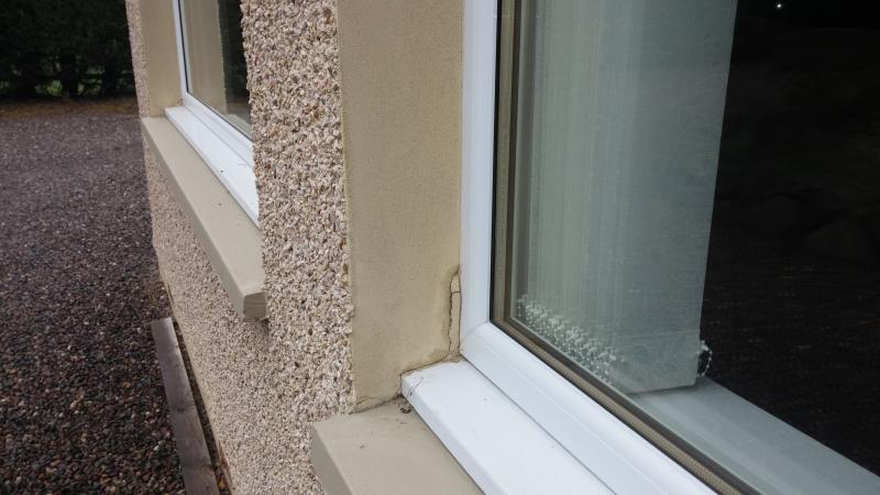

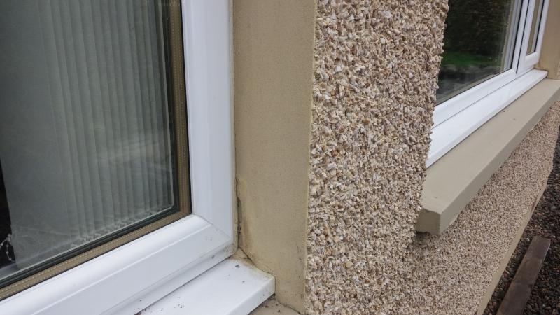

Hi,
Can someone help I had my rough casting done about two years ago now at the window frames it is starting to fall out, how can I repair this as I have tried to fill it in the past but it just falls back out.
The reveals are smooth render. Water trickling down is possibly slightly pooling at the corners and getting behind the render.
As before, hack out a small corner pocket, and then seal between the PVC frame and the brick reveal with pure silicone. Patch with sand and cement, and when the S&C is dry, seal again with the silicone.
