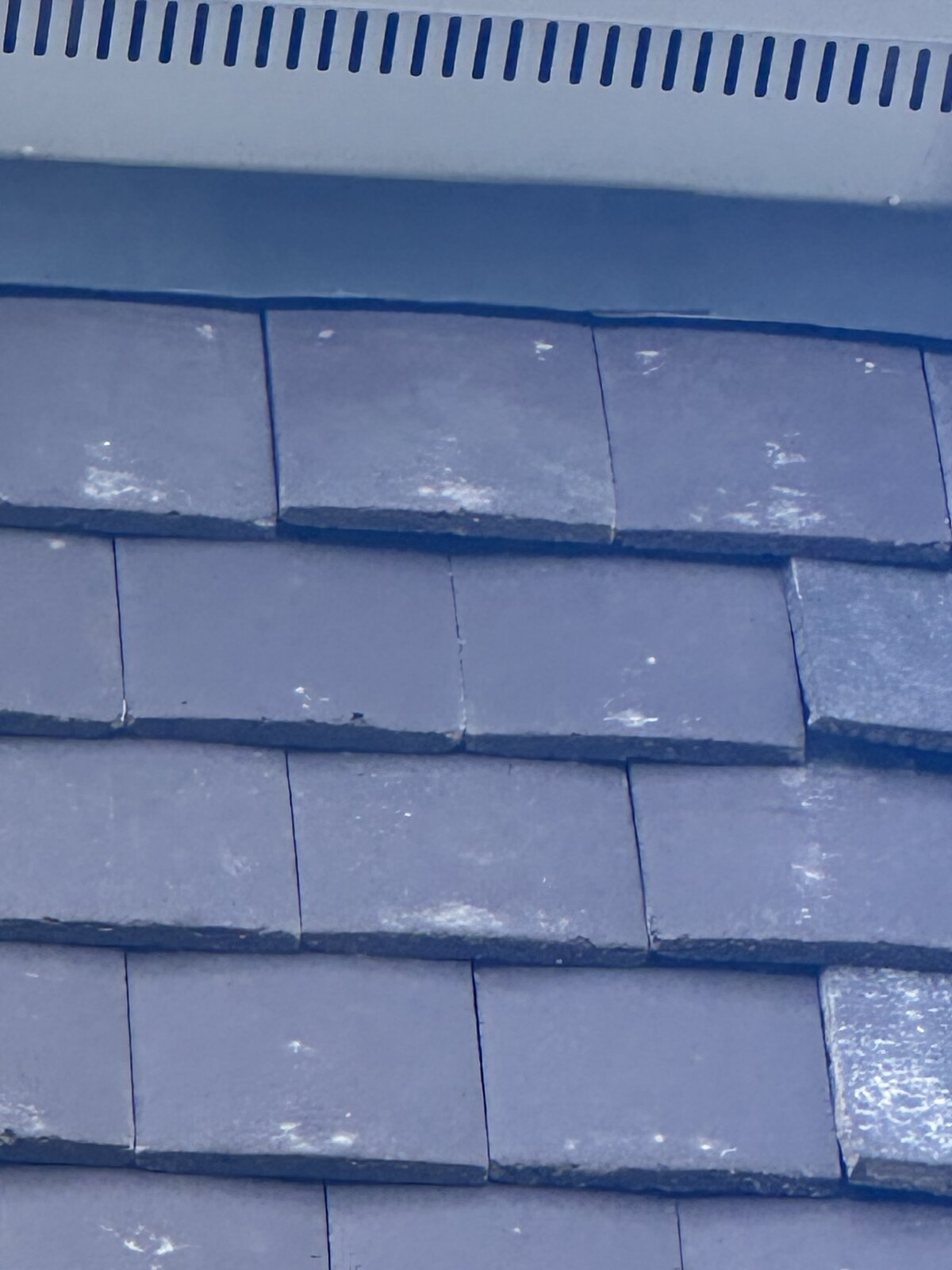

Row of tiles in front of dormer
115 on vertical is ok . I can just see they are over that as have others .
Little cut tiles , amateurish .
The lead at the top is covering the nails but not weathering anything.
Actually it doesn’t even cover the nails

Thanks for all the help spoke with regs and they say it all needs to come off and be done correctly!
