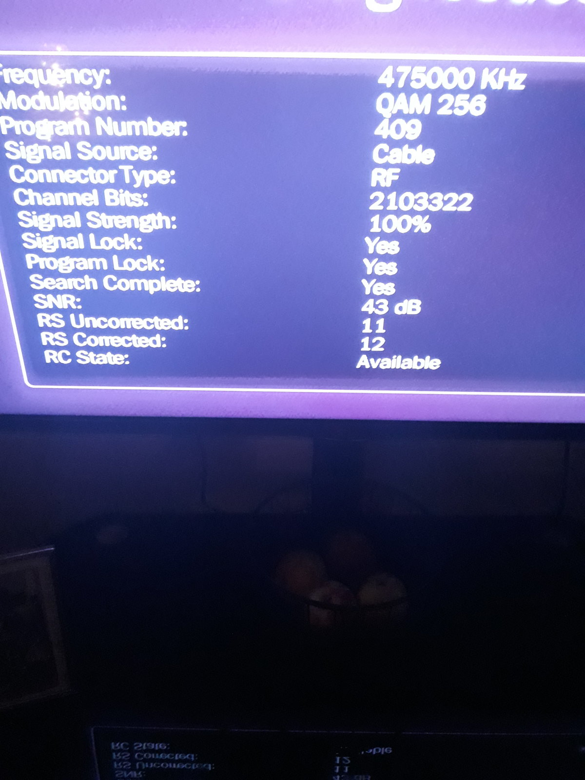

Hi all, its that time of the year when the tree comes out when i set the Christmas tree near the window where we usually always put it. I noticed the tv went a bit funny for a few minutes coincidentally just after i put up the tree in the corner near where the virgin media intake equipment is.
I checked the diagnostics and this is what i found
20191206_182829.jpg what does the rs corrected and uncorrected mean? This is the highest of all 5 channels.

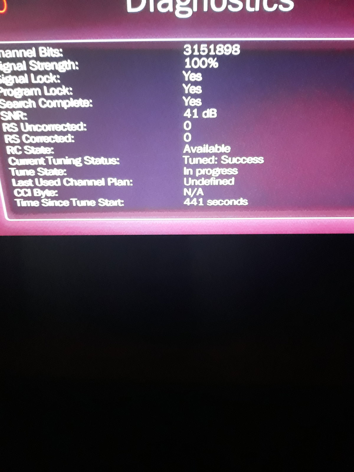

20191206_182232.jpg This is the results about an hour later and all the errors for each channel are back to zero,
Could it have been noise ingress temporarily? The tv has been fine since then and all errors remain at zero.

RS stands for Reed Solomon. It's an error correction algorithm that Virgin Media use. The corrected and uncorrected lines refer to whether or not the algorithm was able to fix the errors that were detected.
The SNR (Signal to Noise Ratio) should be above 34. Yours are, so that's fine.
You got some pixellation because of two things. First was possibly disturbing the cable. Second was the presence of the transformer for the Christmas lights.
I've never really needed to go in to it, but the way that the compression works for MPEG- type transmissions such as digital TV is that there's a key frame followed by a number of images that simply carry the difference between themselves and the key frame. To keep the maths simple, let's pretend for a moment that there are 24 frames of video per second in your VM signal. Every second we send a Group of Pictures (GOP) comprising one key frame and 7 difference frames, then another GOP, then another. Three GOPs per second. Each GOP accounts for 1/3rd of a second. If the signal is affected by noise that wrecks one of the key frames, then that also affects the following 7 difference frames because the base on to which they paint their differences is missing.
Moving the cables (if that happened) can result in the centre core connection sliding in or out a tiny fraction against its contact inside the socket. It isn't damaging anything or coming disconnected completely; it's just rubbing metal on metal at a microscopic level. There's bound to be a little oxidation on the centre core and pins which is getting rubbed off. This is enough to cause some disturbance temporarily. It's a bit like rubbing your hand or some clothing over a microphone. Tightening the outer plug connection if loose enough to turn by hand won't hurt, but neither will it prevent the centre core moving if the cable is bent slightly.
The tree lights power supply is electrically noisy. It's what we call a switch-mode power supply. That means its chopping the rectified power signal to produce the voltage reduction, and in the process it's spitting out some radio frequency and electromechanical interference while it comes to temperature. Your Virgin box is picking this up.
