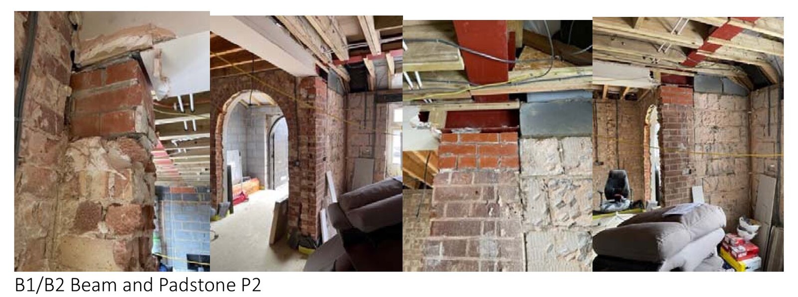

Hello. I've attached an image of a set of RSJs that were installed at our home. Building Control passed this as compliant. Can anyone comment on what they see with this? They don't appear to be dry packed and yes those are bathroom tiles under the bottom RSJ.

Despite what building control say, what has your design engineer specified? That is the standard to meet not building control's.
What you see is very different from what the design engineer set out. RSJs don't come close to spec.
Then it is wrong and not to your required standard.
Building regulations are a minimum, and a very basic level of performance. Basically their concern is that it wont fall down immediately nor fall down with 30 minutes of a fire, that's it. Whether you hear creaking every night or are filling in cracks every year wont both the inspector once he signs it off.

The story is that we purchased this home in 2019 as a completed ''ready-to-move-in' residence. Conveyance report including Building Control Compliance, RICS Home Inspection, Electrical certificates, etc all done and checked out. Previous owner completed several extensions which the Council signed off as compliant during their ownership of the property in 2015. Fast forward to 2021, every part of the extension fell apart and crumbled. The property had no surface drains (drain pipe ran from roof into the ground and went nowhere), RSJs that were spec'd from the structural engineer were replaced with smaller, thinner ones and stacked as you see them above in various parts of the extensions. The pictured ones are the worst where broken bathroom tiles were used to level the RSJs. Pad stones were replaced with breeze blocks and the home was completed with no insulation in the roof, no DPM, no MOT Type 1 (just sand), and a roof held up with pallett timber (the type you see at warehouses). Building Control signed this off as compliant in 2015. Our builders repaired all the issues to correct spec but now Building Control refuses to pass our work because it'll suggest they did their jobs wrong. So the Design engineers and original structural engineers did their jobs, but the owner (also a backyard builder) did the work himself and Building Control passed it all off is the situation. We can't understand how a house can pass so many regulations and end up the way you see in the pictures.
