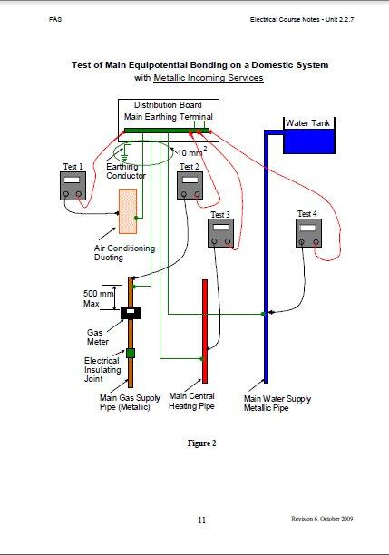

http://www.ecollege.ie/site/liu/electrical_notes/LL227.pdf
Can't remember why I was reading these notes, but found this quoted on page 11:
"It is possible to supply the single-phase loads through a three-phase RCD. This would simplify the arrangement a good deal, however it is not recommended to supply a mixture of single and three-phase loads through one RCD"
Can't remember why I was reading these notes, but found this quoted on page 11: ....

This is the actual document with the correct page 11:
http://www.ecollege.ie/site/liu/electrical_notes/LL232.pdf
which has this:
three-phase loads through one RCD. The reasons for this are beyond the scope of Phase 2 of the
apprenticeship.
and no explanation as to why.
This is the actual document with the correct page 11: http://www.ecollege.ie/site/liu/electrical_notes/LL232.pdf
which has this:
three-phase loads through one RCD. The reasons for this are beyond the scope of Phase 2 of the apprenticeship.
Thanks (it helps to have the correct link :-) ). It would seem that the reasons are not only "beyond the scope of Phase 2 of the apprenticeship" but also beyond the understanding of most of us here! As has been said, in some situations there may be an argument for separation of circuits, but AFAIAA that's got nothing to do with whether they are 1-phase or 3-phase circuits.
