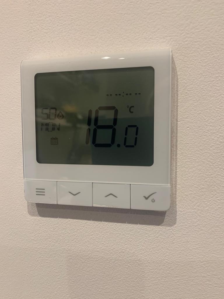

What is the most efficient/cost effective way to run wet UFH ? We have Salus thermostats in g/f rooms. 1 Rad downstairs and 1 heated towel rail/ upstairs same. New build with good insulation. We are retired so are at home most days.
Don't like the house too warm during the night. Interested to know what works for you ? Timings, temps etc ?
Has anyone used an online "smart" system and was there any real benefit ? Salus offers this option.
We find the boiler kicks in regularly at night and this can be quite noticeable for light sleepers. I've started turning thermostats down at night to a temp that the house is unlikely to drop to.. so that the boiler stays off during the night but doing this makes the house colder in the morning.
Underfloor should be run with a back set temperature of no more than 4C below desired room temperature.
Try reducing to backset temperature well before you go to bed bring it back up maybe an hr before you get up .
Which salus stats do you have?
Hope this helps
