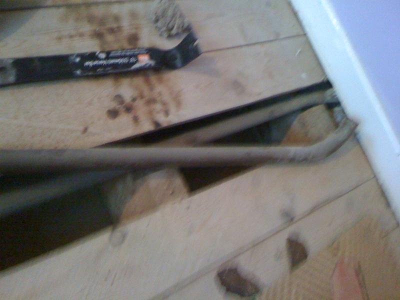

I've stuck my hand up the chimney opening/breast and i can't feel a lintel which concerns me, the house is heated by a reasonably newish combi boiler, turning that on and leaving the radiators to warm up suggests its been cut off from the heating system at some point as it remains cold. I can't find where it's been disconnected though, i've had a few floorboards up so i assuming the pipes must be buried deep in the chimney.

As for the pipe work it is more than likely just cut off and plastered over at the side of the brest or going up one side in a stud.

I don't know how i missed it (feel a bit silly :cool: ), but you were spot on about the boxed off partition on the side of the breast where the pipes exit out.
It's kind of hard to explain put the pipe work for the boiler runs up the side of chimeny behind a layer of bricks - judging by this i'm starting to think the boiler was put in before the floorboards were put down, and was part of the original build - upstairs directly above where the pipes come up, the floorboards look untouched and show no signs of tamper (tongues and grooves still interlocking).
