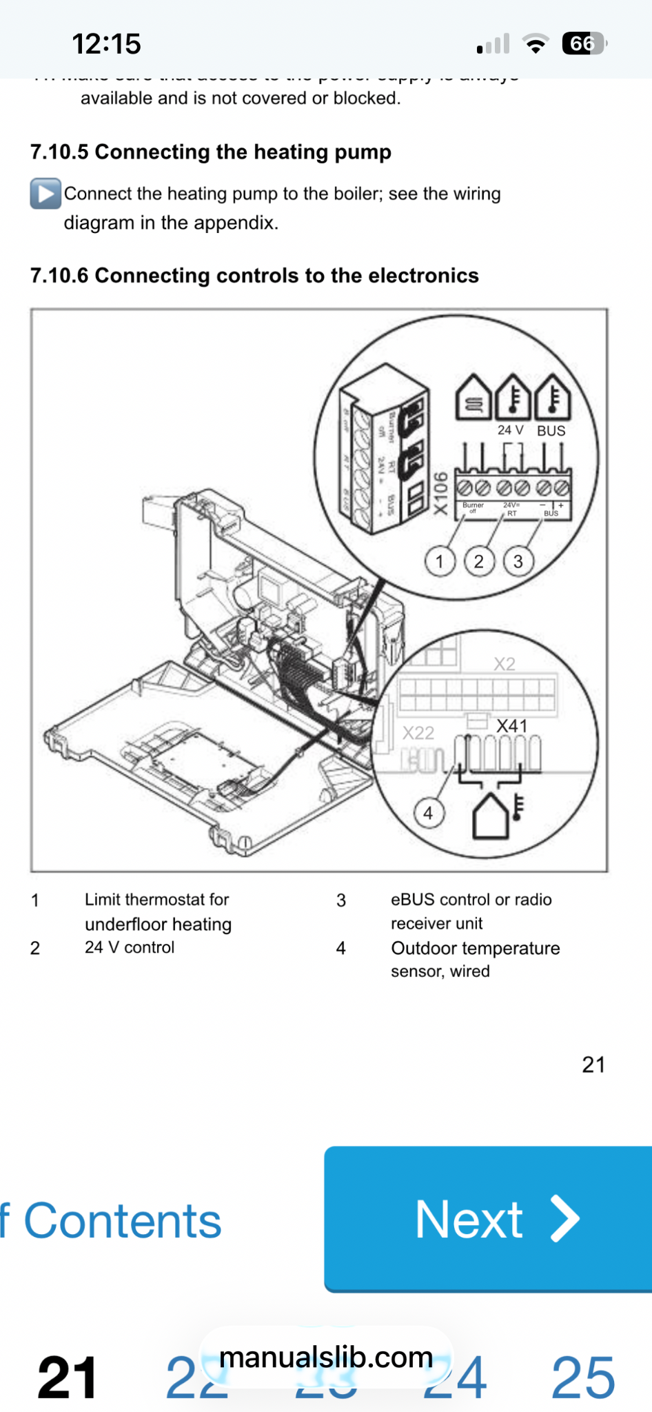

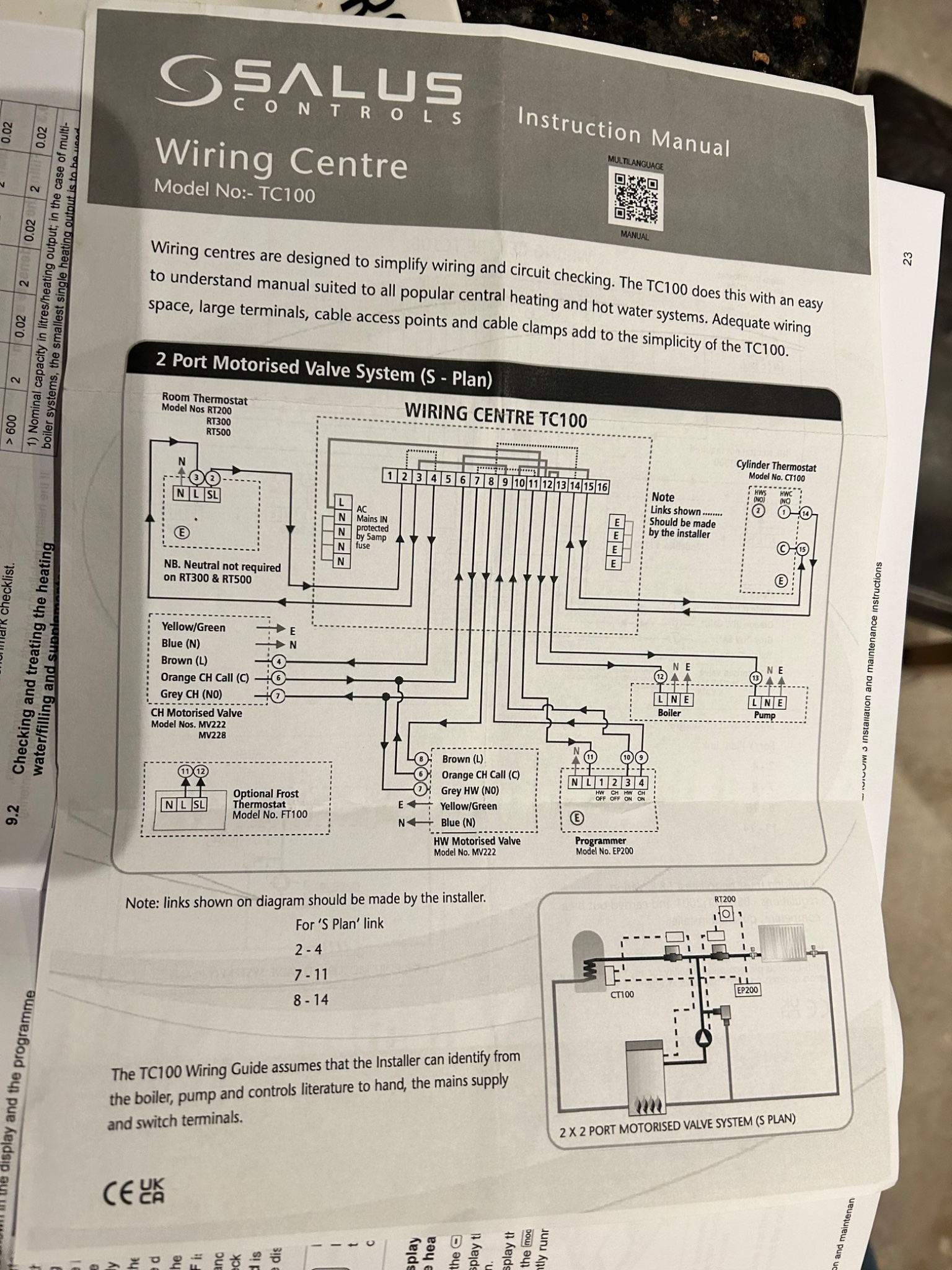

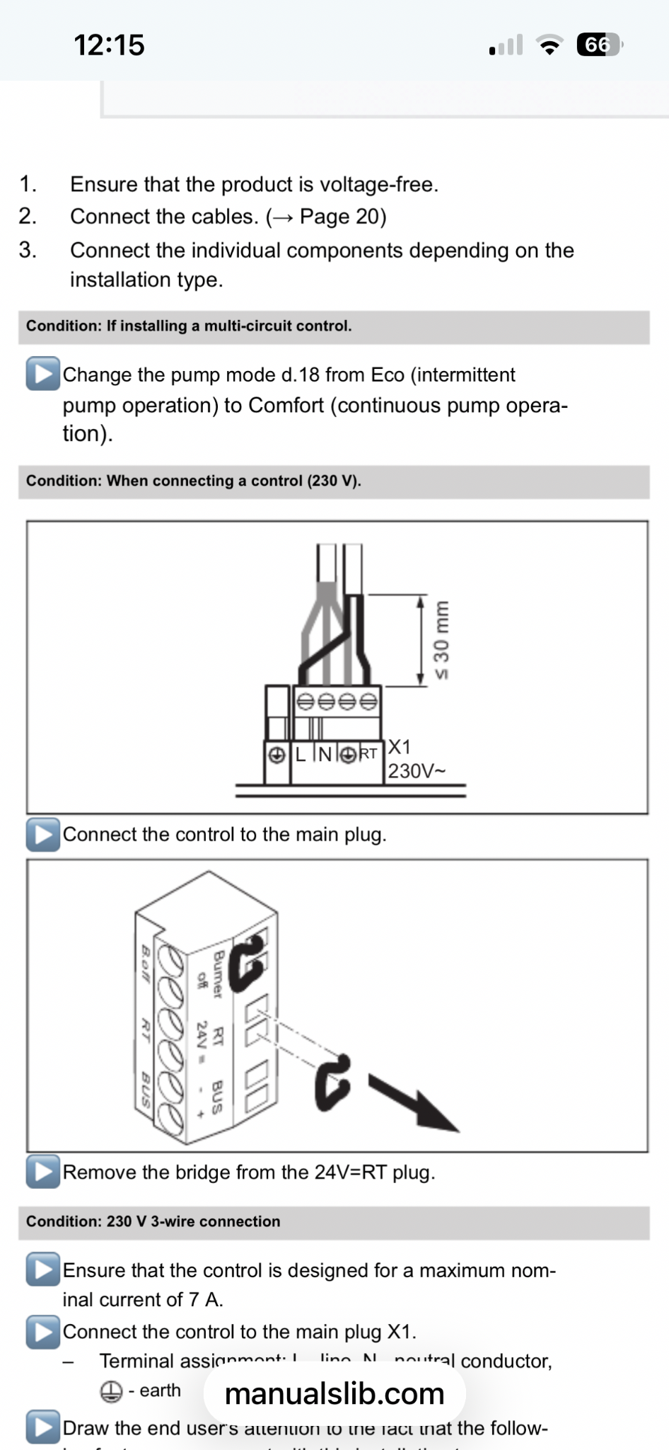

I have a s plan set up and can follow all the wiring instructions that come with my wiring centre except one. Im not sure where to wire the live on the boiler when heat is demanded by the programmer.
I’m thinking it would be the RT terminal and then removing the link. However the diagram on the wiring centre states it is a single live wire (switch live?) where as the boiler manual shows that there should be a two wire connection?
See pics

Yes, it would be the 230v RT connection, single wire/core. The 2 would be for a 2 wire stat or ran to a wireless stat. SL from MV to RT via wiring center
The boiler manual is showing 1 core coming out of the boiler live (which is what should be feeding your wiring centre), and one going back to RT (switched live). So yes, wire into the RT terminal next to the mains terminals, and remove the link on the 24V RT. DO NOT put mains into the 24v RT
