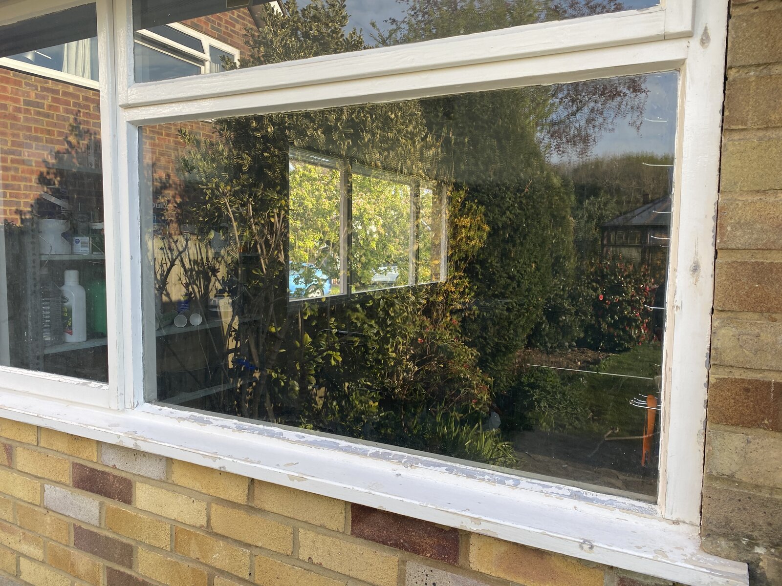

I bought some sadolin superdec white satin to paint my garage window after reading great reviews. Says on the tin it covers everything.
I painted the first coat today and it’s like nothing has been painted on. The paint looked translucent when doing on.
What did I do wrong? Pictures below.
I have never used it. Did you stir it properly? When buying tins off the shelf, I normally ask the store to put them in the shaker.
Hi. Took your suggestion and gave it a good stir before second coat and it has gone on much better. Thanks for help!
It usually takes three coats to fully cover up bare or dark wood.
Fortunately it dries quickly.
Give it a little stir now and then as you go.
