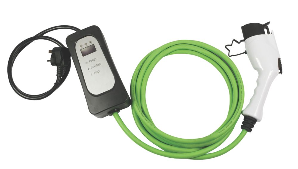

But as with my E-bike you can get car chargers which simply plug into a handy 13 amp socket. Even the charger points
ae235
have a type AC curve B RCBO, it says
For the installation to conform to IET requirements, the appropriate RCD should be selected by the electrician and fitted at the incoming source.
so why fit a RCBO next to socket? And nothing about not being suitable for use with a TN-C-S supply, there is clearly something in the cable
ae235
I tried to find a data sheet for Masterplug MASEVCP1135SLMP but failed, it may disconnect the earth under fault conditions but there is no info to say what is inside the box.
