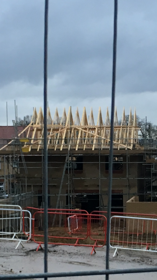

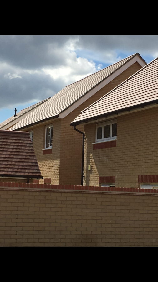

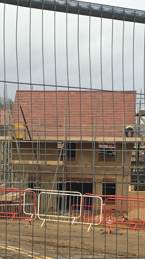

Our new home is 6 months old. On home preview we noticed a wave in the rear of the roof. We have other major problems to. We considered delaying completion but was promised all issues would be remedied. Great we thought!!
Now the builder has retracted this. Can anyone identify from the pics what is wrong with our roof? During the build I took various pictures which show different heights of wood along the roof line and uneven spacing. Are these trusses? Not sure what they are called. Ridge tiles are also uneven.
Feel large building company is fobbing us of. Any info/ideas greatly appreciated.

I wouldn't lose any sleep over it, if the other side has the opposite
effect then one of the trusses has been knocked out of line.
Looks ****e and would pi55 me off too. I doubt they used a string line and blocks to line those trusses up.
Catlad: when you say the other side, do you mean the front of the house?
The front of the house is perfect. As if they have lined everything up for the front view.
ajstoneservices: P155e5 me off every day! My dad was a roofer so I know he wouldn't have left a new roof like it. If he was alive he would have been disgusted with Redrow's workmanship. As I said this isn't the only problem. I shall do seperate posts on them tomorrow.
It also looks as though they've used different sized rafters, and this may have a bearing on the height/levelness of the ridge. The spacing on the rafters also looks uneven, and how have they levelled the roof line before tiling
