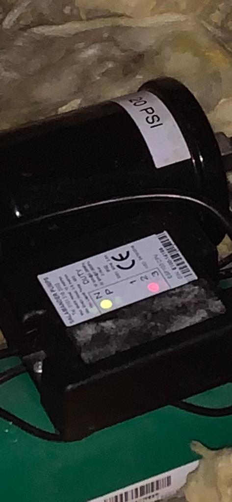

So have these fault lights on my pump and was working great for years but now this has happened? Is there a fix for this I can do or is it a dead pump
many thanks
1. What model of Salamander pump?
2. Probably needs air pumping into the vessel marked "20 PSI", instructions should say.
Thanks for reply
All sorted
Complete an air test!
Follow these instructions to remove air from your pump installation.
1. Turn off pump.
2. Remove shower head from hose.
3. Let hose hang into bath or shower tray.
4. Turn the temperature to full cold.
5. Turn the shower on and run for 5 minutes.
6. Turn the temperature to full hot and run for a further 5 minutes.
7. Turn off the shower.
And it worked! So all good
Hope this helps somebody else with the same problem
