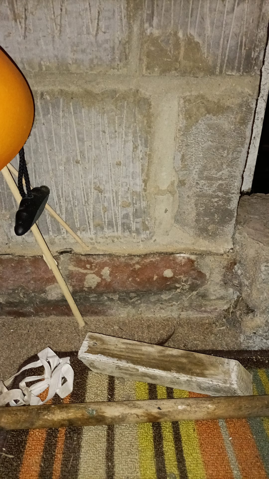

Next question.
This is for a garage - not a conversion just making it better.
At the bottom of the wall there are two courses of brick (sloping up towards the back to just over a course), then DPC then blocks above.
I want to render as close to the floor as possible, so i dont have a gap of around 5 inches. I am hoping to tile the walls, and am considering a floor tile as skirting as well - rather than wood.
How can i fill the gap once rendered, as presumably i cant render past the DPC? I had thought of adding an additional DPC as i render the walls, or leaving a small gap in the render, but then when i tile/skirt this gap would then be closed off - defeating the point?
any other suggestions - the proper method?
Pic for reference:

You should not bridge the DPC with render or plaster. Leave a gap. It can be done with a bell cast or with a temporary wooden batten that you remove later. Either will leave a neat edge, the bell cast also provides a drip.

A very superior way to fix skirting, which spaces it off the wall, is to screw an 18mm batten to the wall so that its top matches the top of the skirting, and another near (not touching) the floor.
You can render or plaster neatly to the top batten
you can shim or fill behind the battens so they are flat and even, to correct a wonky wall. You only need small screws to fix the skirting to it. This is very suitable if you have stained or varnished skirting and use small brass screws.
There is a channel between the battens where you can run TV, LAN, phone, alarm or speaker cables if you wish (mains power cables not permitted).
This method takes extra time so is not usually done by professionals except on fine work.
