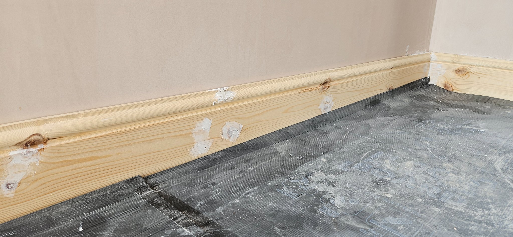

I used to like timber for skirting and architrave but now that I've got to prime and fill it myself, I wished the chippy had bought MDF.

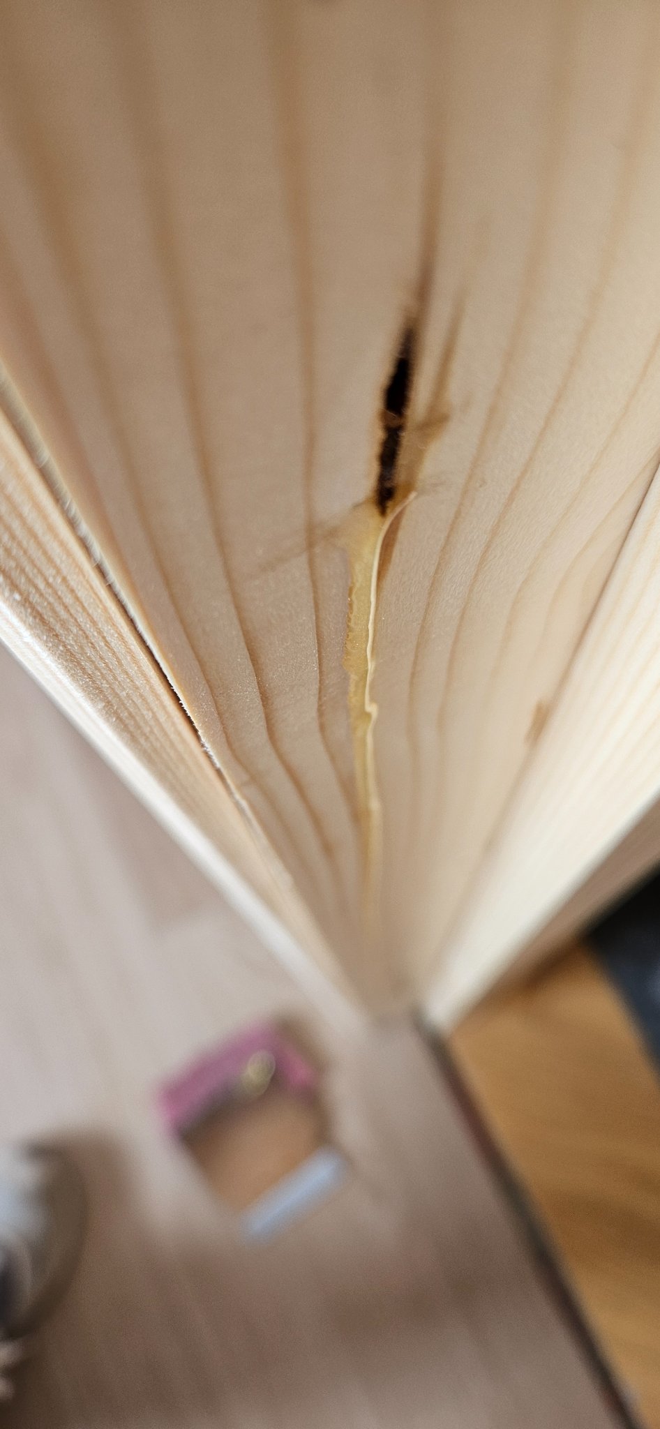

I've got pine sap running out of this door linning and there's a ton of knots in the skirting that I know will bleed through unless I get my prep right.
I've got some Ronseal knot block primer and undercoat. Any other advice that will give me a decent finish?

Dig out bad knots or problem areas and you can use 2 pack wood filler.
Aluminium primer I used on my pine stairs as the knoting solution failed and its been fine.
Give the aluminium primer a few days to cure following spec then 2 coats of acrylic primer.
Aluminium primer is gray unfortunately.
That's the best.
Next best is a shellac paint like Zinsser BIN but it's not a sure thing
What's a two part filler?
It’s a filler where you mix two components together. One is a “hardener” that is a catalyst that starts the reaction that makes it solidify.
Example: “Everbuild 2-Part Wood Filler”.
The sap can be removed with white spirit but I would recommend waiting a few days before painting. It is likely to weep for a while.
I had to hang doors for a mate a while ago. The new door stops were extremely resinous. So much so that a lot dripped on to the new laminate flooring that I had fitted.
I pulled a few of the worst knots out. The "shakes" continued to weep for another 4 or 5 days.
I hit the knots and shakes with the shellac based Zinsser BIN and then used 2 pack filler, then hit that with another coat of BIN before priming with acrylic primer and followed up with 2 coats of oil based eggshell. That was 2 years ago. I did warn him that no product is guaranteed to block knots forever. Seem to be OK thus far though.
I had the same problem. I've just laid a laminate floor and I noticed a small pool of sap on it from the door linning. I scrapped it off whilst it was wet.
I was trying to sand that door lining today but my sand paper stuck to that part so thanks for the white spirit tip.
I've ordered aluminium primer now. I think I have some BIN somewhere, if not order some of that too. I've a staircase to paint too so it will get used.

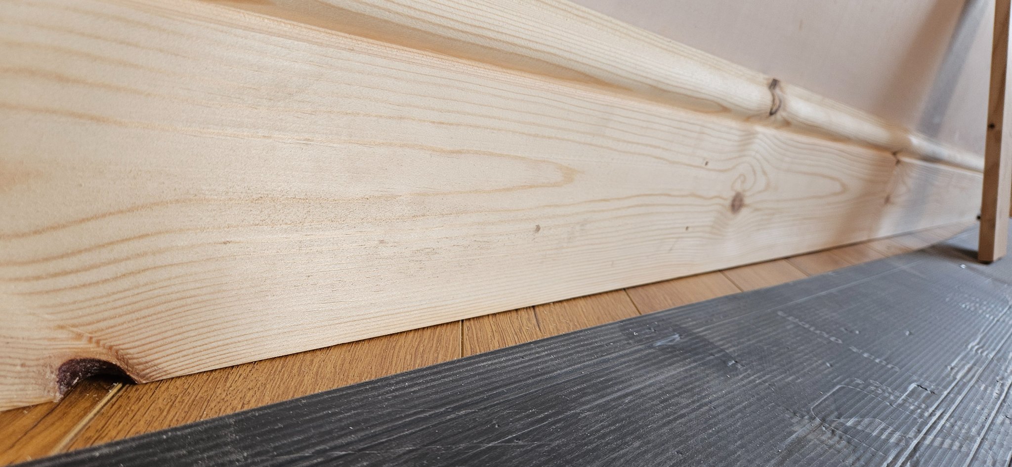

BTW, the knot in image 3- slide a slice of plastic rubble sack under it and then pack it up with scraps of plasterboard until it is level with the underside of the skirting board. You will then be able to fill it with 2 pack filler. The plastic will pull away after sanding. If you hit the knot "nearly" flush and then do a second hit, you will have less sanding to worry about.
