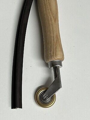

Anyone got any tips for installing door seal into groove of door frame, can’t push it in or slide it in, hammering damages it, any external pressure starts to rip it?
Warm water and fairy liquid
Don't use wd40 it will rot the seals.

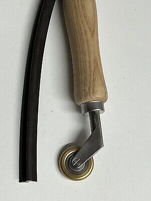

A bit late, but Schlegel actually supply a roller installation tool to make the job easier. A right faff without it
