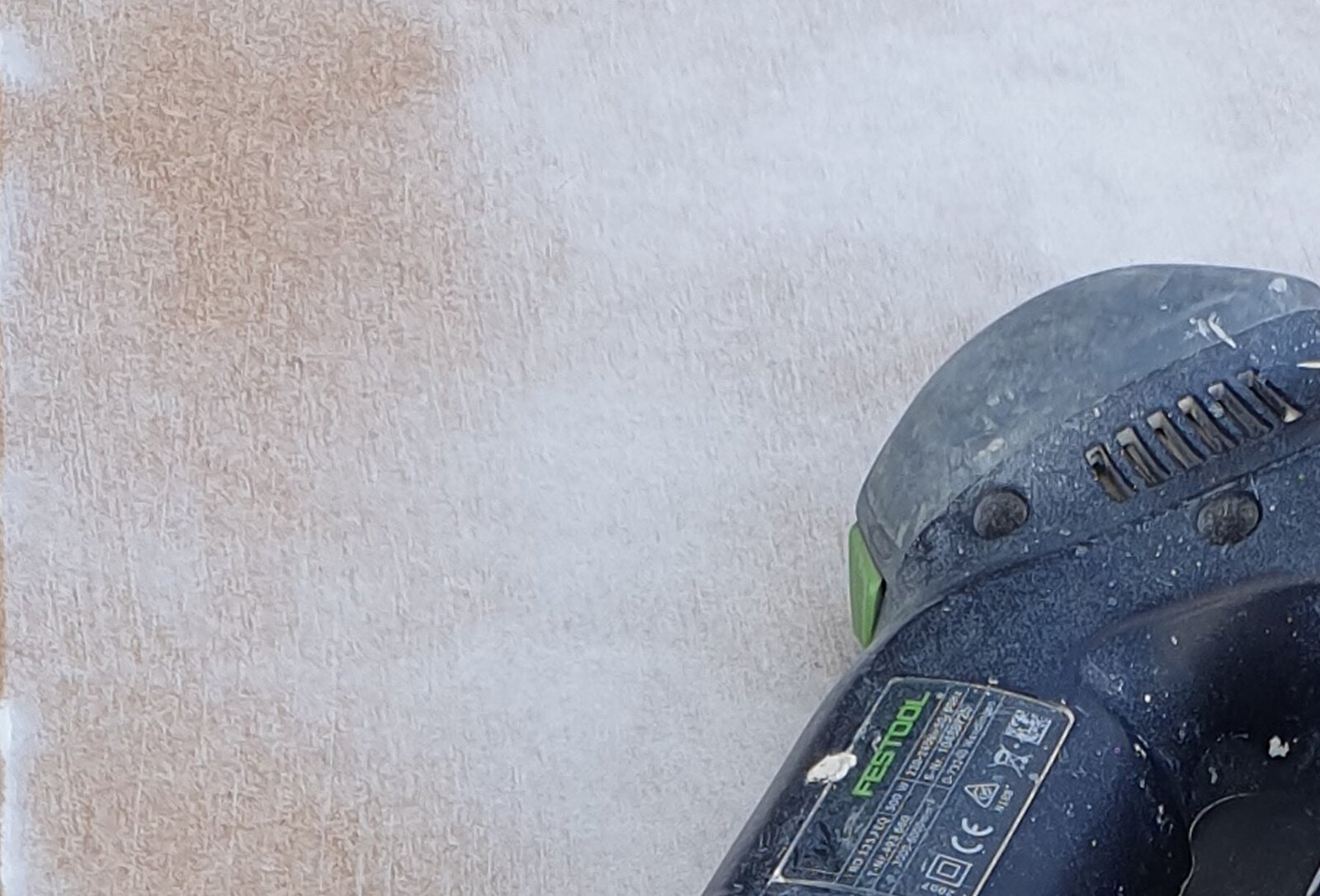

I used Leyland Trade acrylic primer, knowing that I would have to then sand that flat. I used the paint as a visual indicator. Once I could no longer see the manufacturer's score marks, I was content that it was sufficiently flat. The following image shows the degree to which I would sand it back.

Dug out the bin primer and did one end where I'd shaped it and it only raised the fibres a little bit, they sanded back nicely, so gave it a full coat, applied with a roller and laid (layed?) off with a 3" soft brush. The only issue I encountered was that, because it's a long sill, about 4m in total, and the temp was around 23c+, I got some dragging/sticking when laying it off, and could have done with something to extend the working time. It was drying faster than I could smooth it, so there were some less than smooth areas, because of that. I left it over night and gave it a sand this morning and it came up really nice. It will definitely need at least one more coat, as some of the areas where it was back to bare MDF, are showing as darker patches, but other than that, it's all good.
