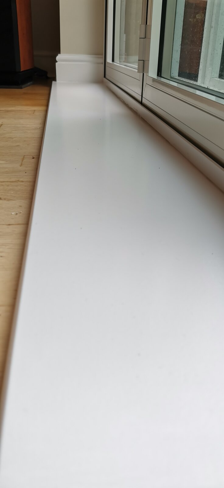

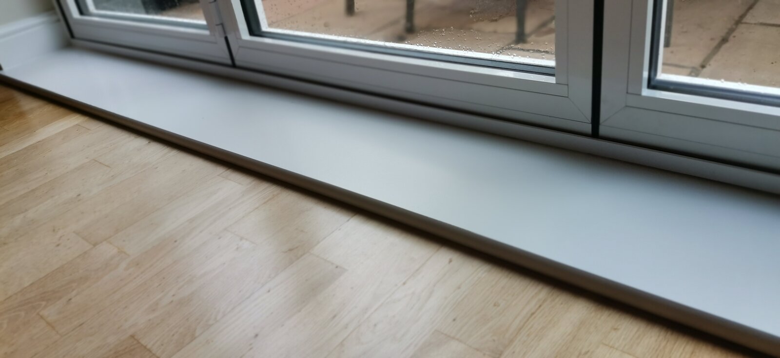

Thanks for the tips. Some feedback in case it's of help to anyone reading this later.
I couldn't get the Uni Pro 6.5 sleeves in time, but got some short-pile Two Fussy Blokes ones.
Got up early for lower temps (the Scuff-X has a working temp range of 10-32.2 deg C). Worked at 21 deg C or less.
Brushed a test piece of MDF (already primed) first to get a feel for the paint. Later wiped the threshold board with a damp microfibre. Cut in edges and then rolled the Scuff-X on and laid off once. I found this much easier to blend to the brushed edges and the wet edge from the previous section compared to the previous paint which was thickening before I could do anything.
It had a dimpled appearance initially, but because I'd done a test piece and knew what to expect, I was happy to leave well alone.
Flows out beautifully and was smooth after an hour.
Denibbed and second coat this morning.
I think a lot of the problems I had the first time (apart from my inexperience and use of the wrong roller type) were caused by the multi-surface paint, which was unnecessary and unsuitable.
As others have said, the Scuff-X is expensive. I probably would look at other decent quality paints if painting a bigger area. Because I had had issues with this piece already, had spent a lot of time sanding back and wanted something a bit more robust because of where this is, I plumped for the Scuff-X.
From my limited experience, the positive reviews elsewhere about using it are justified. That's not to say there aren't other good paints, of course.

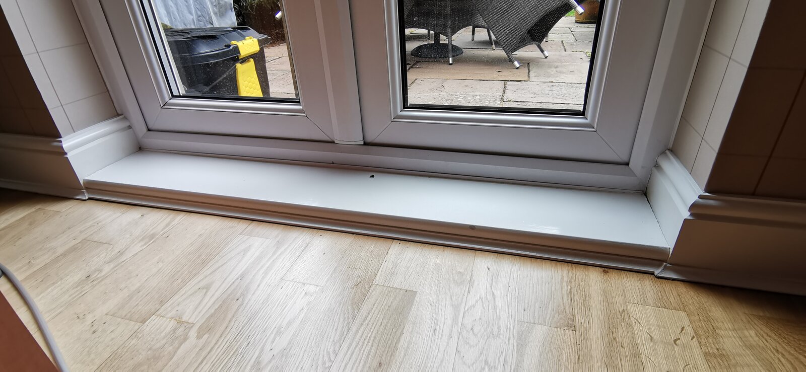

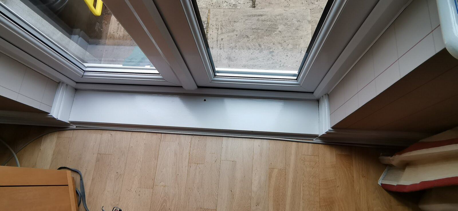

Fwiw, the original gloss threshold was there when the house was built. We had it painted 20 years ago and it held up fine as shown here. There's one mark on the bullnose here, but that's only because I'd just jemmied the board out so we could check what's underneath with the bifolds surveyor.
I appreciate it might not be the optimum solution, but we decided against hardwood this time as we were decorating to lighten up the lounge and had chosen white bi-folds for this reason and to match the rest of the windows.
