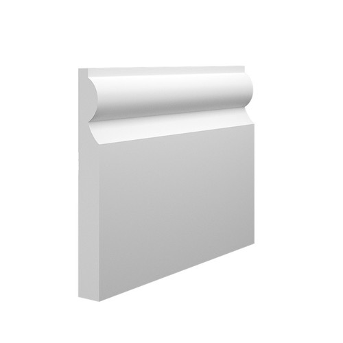

I bought some Torus from Skirting World and went for primed and undercoated.
The profiles needed sanding but the flat surfaces were smooth and ready for painting.

The large flat section at the bottom did not require sanding (I did sand with 240 after first coat)
The angled and round bits were a little rough as not touched when it went through their sander and needed sanding before painting.
With the style you are going for, the recess may need a sand but the rest should be pretty good.

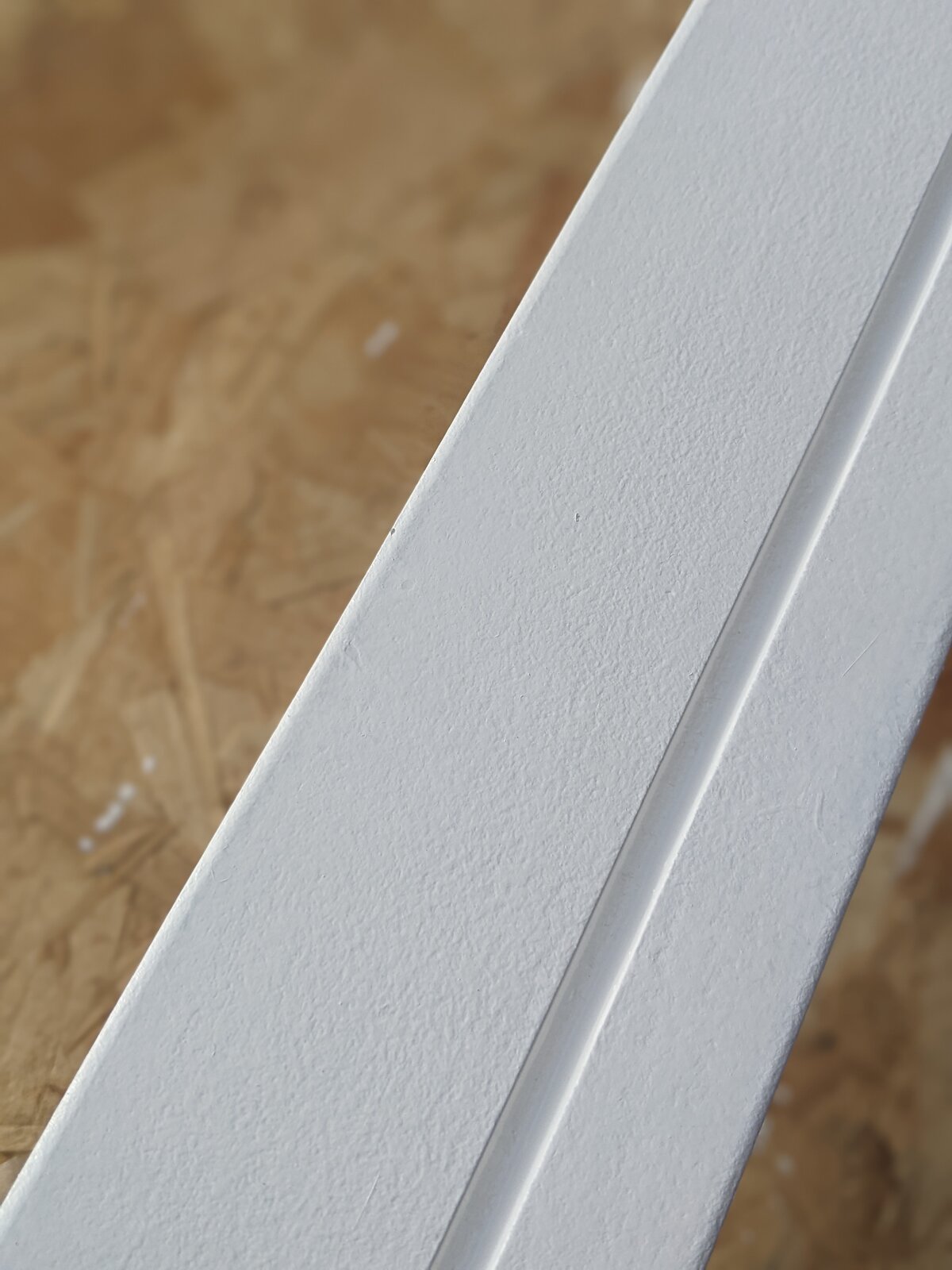

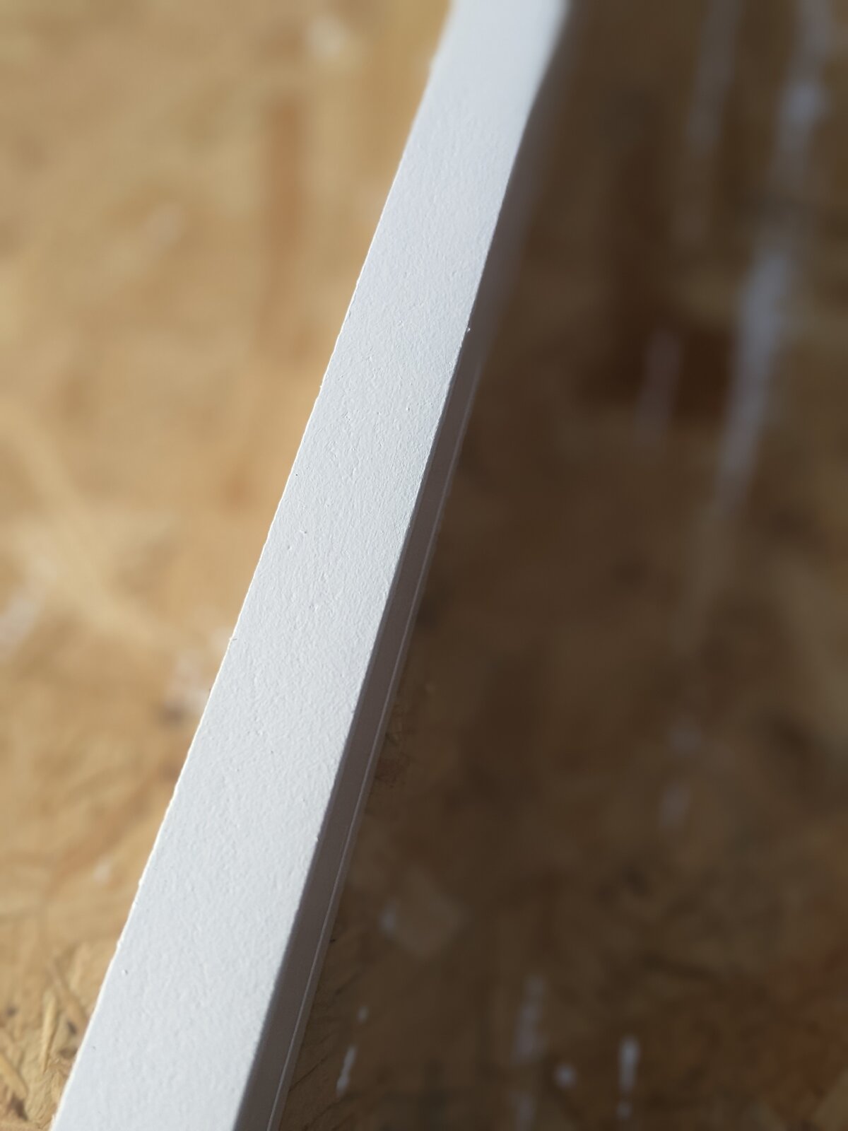

This is what I got after sanding with 240 two coats primer two coats satin top coat. Both water based as that's what I have right now.
It's an improvement but still getting some mottling.
