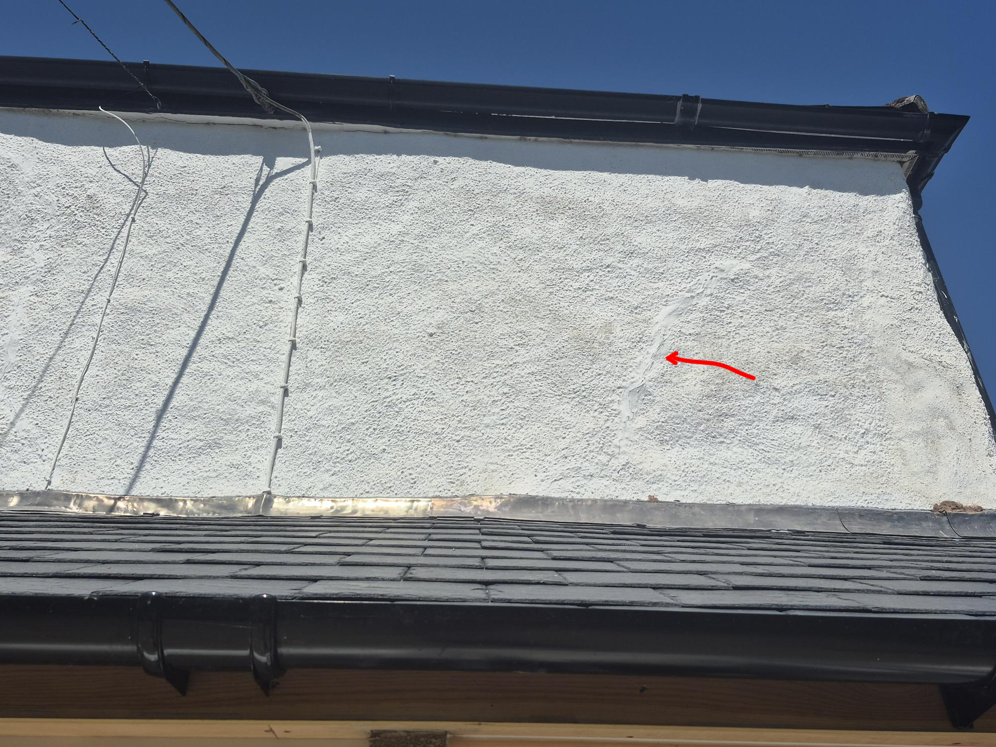

Just thought Id upload some photos. This one shows hairline crack. Its obviously been repaired/sealant used in the past:

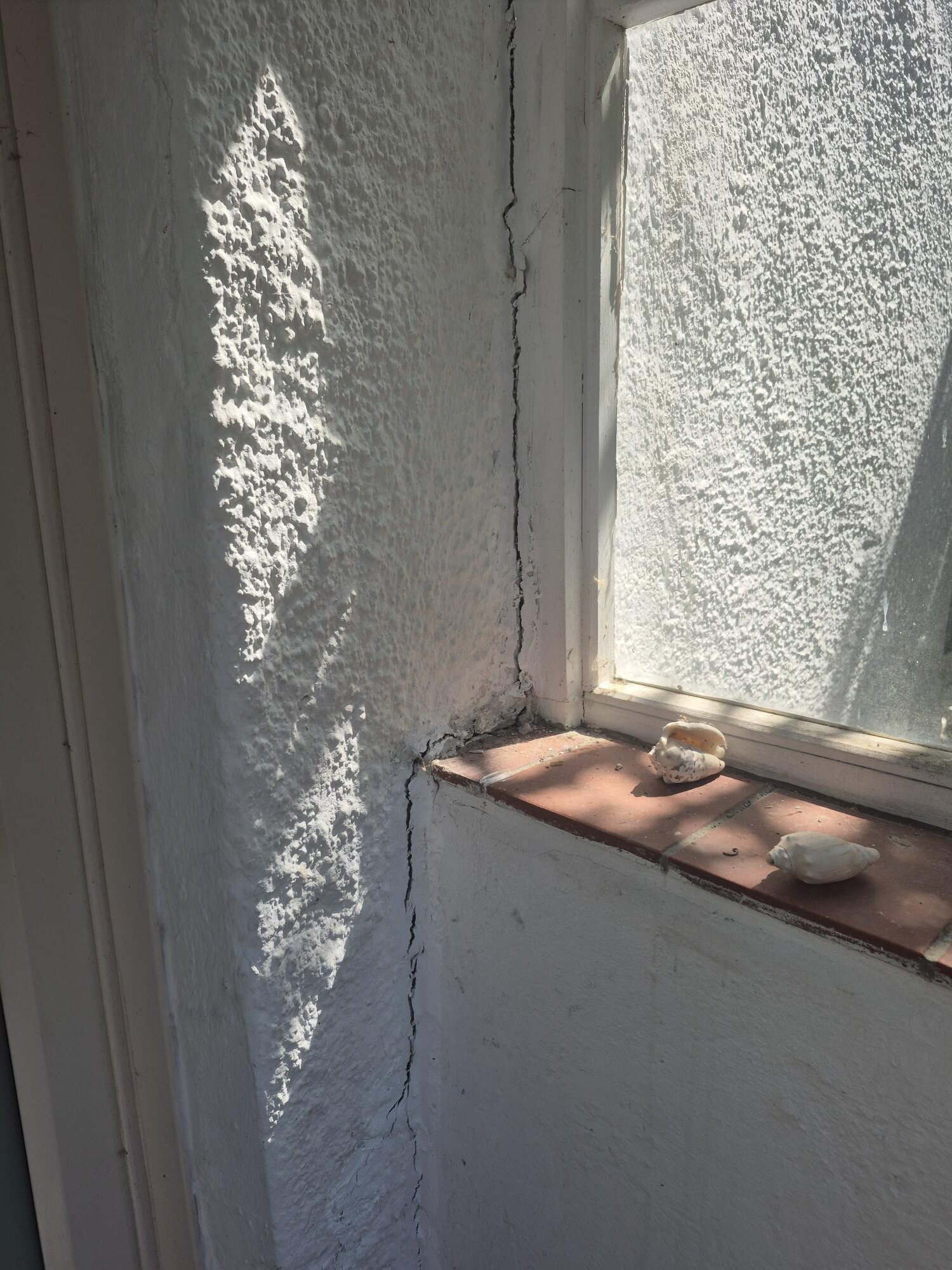

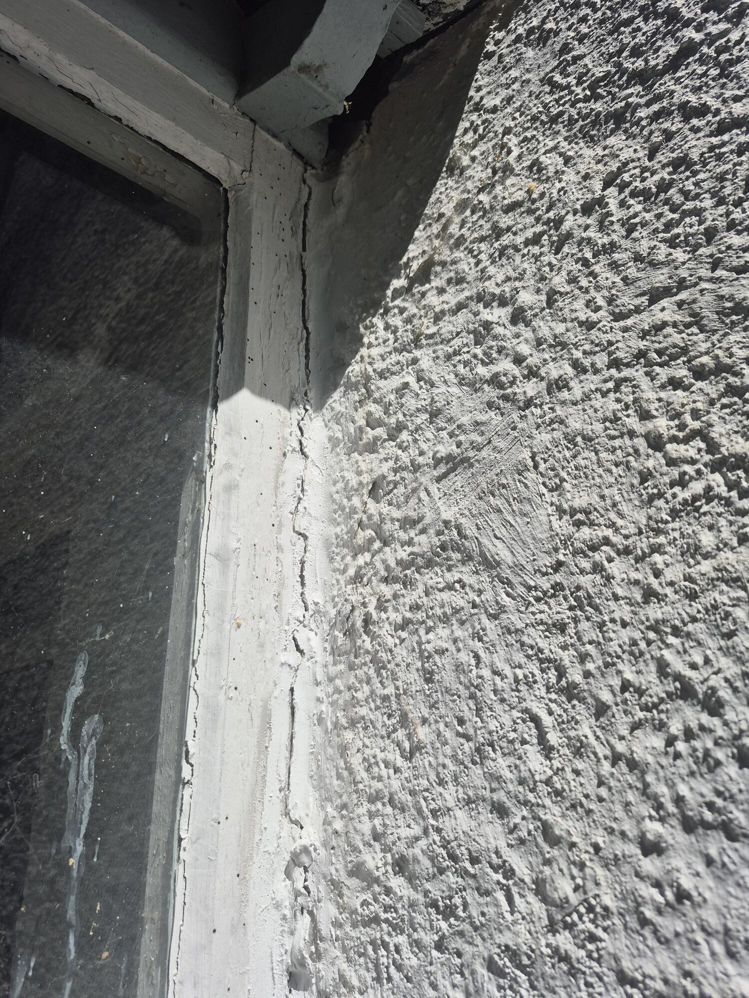

These are bigger cracks, thankfully at ground level. Each year I use a flexible external sealant. But it gets the full sun, so the cracks re-open. SO I need a more permanent solution - hopefully Metoset will do the job.
