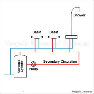

These are used for larger systems where there are long runs of pipework far away from the hot water tank. The purpose is to avoid large quantites of water becoming cool in the pipework which would then need to be drawn off before hot water reaches the outlets. There will be 'secondary return' pipework where the water is pumped from the extermeties of the system back to the tank to maintain circulation. The photo attached might help to explain it a bit better. Apart from the nuisance factor of having to wait for hot water to come through, there is also a risk of legionella where water is left stagnant and allowed to cool in the pipework.
The reason the pumps are more expensive is because the pump is dealing with fresh oxygenated water so the internals are usually made of bronze to withstand this, this is unlike a CH systems where the pump will be circulating the same (hopefully treated) water.

These are used for larger systems where there are long runs of pipework far away from the hot water tank. The purpose is to avoid large quantites of water becoming cool in the pipework which would then need to be drawn off before hot water reaches the outlets. There will be 'secondary return' pipework where the water is pumped from the extermeties of the system back to the tank to maintain circulation. The photo attached might help to explain it a bit better. Apart from the nuiscance factor of having to wait for hot water to come through, there is also a risk of legionella where water is left stagnant and allowed to cool in the pipework.
Ah, right. Thanks. If I'm not mistaken such a system is very common in hotels and suchlike buildings.
