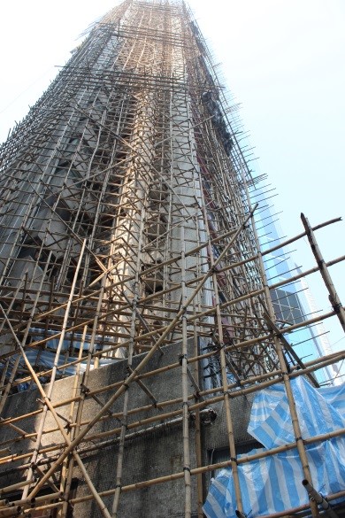

Well options are steel or aluminium so if you don’t want to use them you are left with Bamboo.

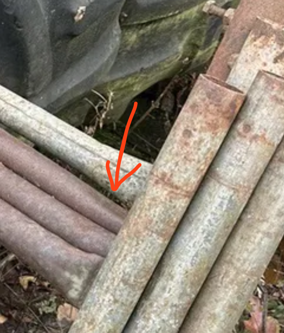

Avoid the steel H shaped scaffold like the plague; seems everyone who owns it ends up using a hammer to beat it together (or apart) which distorts the pipe being beaten, bending it and pulling the connectors out of alignment, meaning they then beat it harder next time. Don't buy any secondhand stuff that's obviously not got circular tubes near the connectors; it's really hard to straighten out so it slots together nicely ever again
