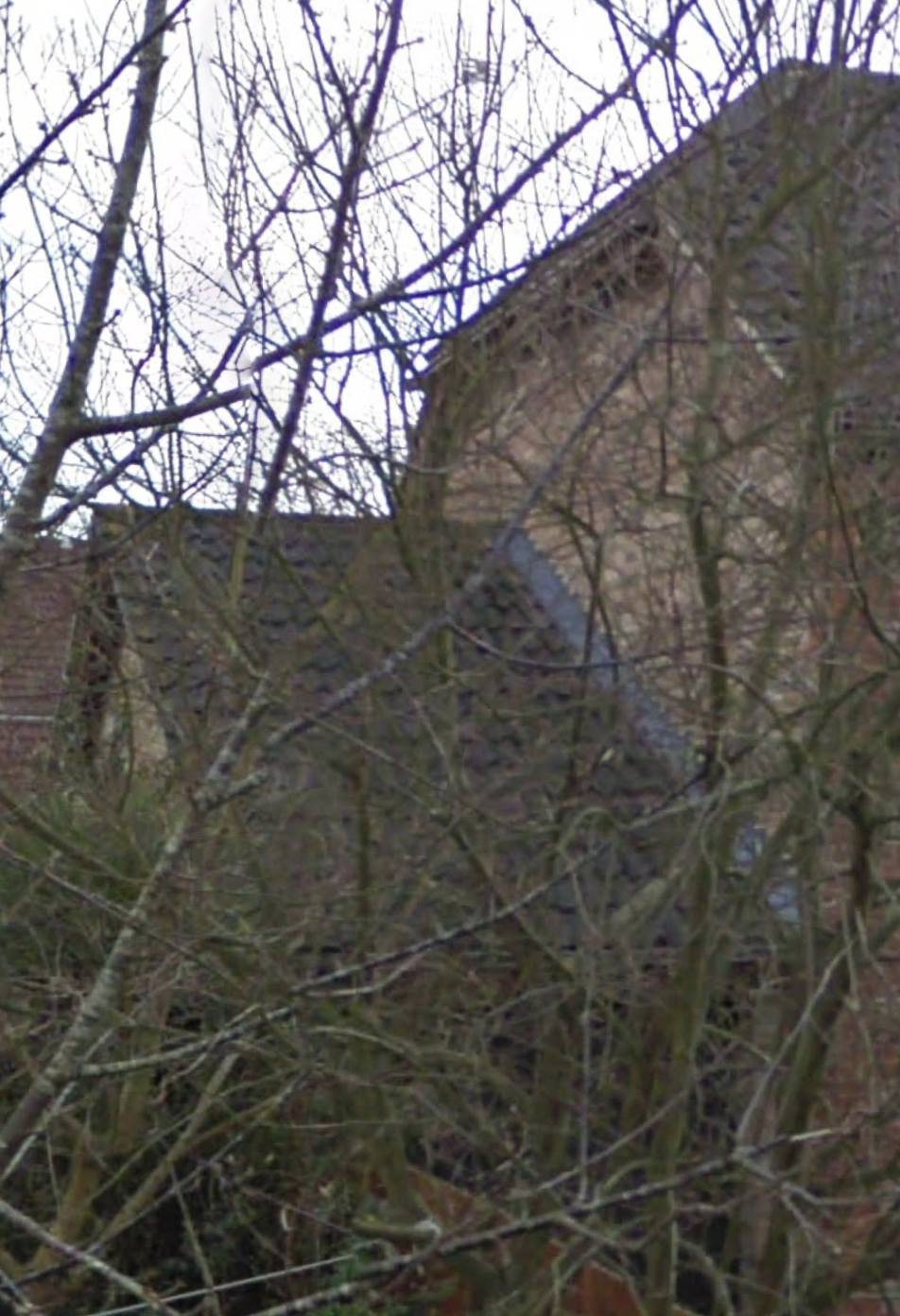

This is my problem area, I may just get a quote for this side of the property. It's in the pictures (google maps crp sorry)
The apex starts 3/4 over the side of the house so a cherry may work and I could work on the tiles, not preferred though.
Hire for a platform for 19 days is 500 odd, on the rear of the property
Cherry is an option as I could deal with the garage side.
