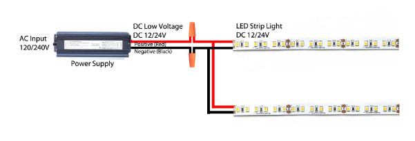

This is the strips in series:
This is the strips in parallel:

Justin, you can wire them either way, you will not need another power supply as it was designed to power all those LED's.
We find it is important to clarify, because true electrical series connections will change the required input voltage. When people talk about wiring LED strips in "series," however, they almost always connecting LED strip sections end-to-end. When connected in this way, the LED strip input voltage remains unchanged. In other words, you can use a 12V power supply to power a 4-ft section of 12V LED strip lights with another 3-ft section of 12V LED strip lights daisy-chained.

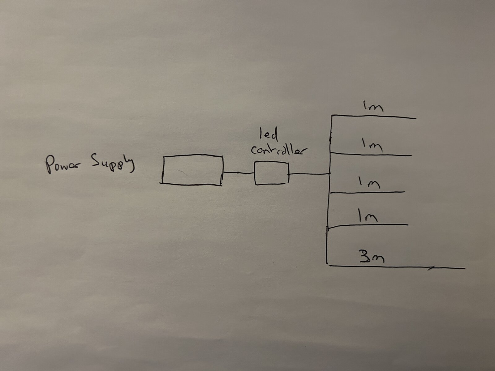

Thanks for all your replies. Because of the layout I want to run cables to each strip and preferably wire them in parallel from the controller. Here is a very rough drawing. I'm just not sure what size power supply to use. In total will be around 7m of RGBW strip. I'm guessing certain manufacturers have a different wattage per meter which also confuses things? I will probably purchase from Amazon. The LED controller will probably be one of these as I use Smart Life to control my home lighting and sockets. https://amzn.eu/d/5Pct0KN
Been to a few sites where joining strips end to end and creating over 5 meters has caused the first connection to fail
Most shop shelving utilises seperate tapes and each wired back to one unit as you propose.
24v is good choice and seems more reliable, look on uk commercial led sites they often sell more reliable stuff over the cheaper imported stuff and tend to state the wattage per meter, and recomended power source, 10 metres of any tape will always give the same total wattage as + and - will always be parralled regardless if you go end to end or any combo of branches

For SMD 5050 LED Chips, each Chip draws (up to) 0.2 W.
If you had a Strip with 84 Chips/Metre this would use (up to) 16.8 W/m.
At 12 V, this is 1.4 A/m
For 7 Metres, (at 12 V), this would require 9.8 A.
In that case, I suggest the use of a 15 A Power supply.
which is equal to the capacity of your proposed "controller".

Thank you! I am looking to use 24v strip however

I've never used these but my understanding is if it's 3 amps per channel and the positive is shared, you're limited to 3 amps per controller. At 24v 7m is right on the threshold @ 10W/m.
