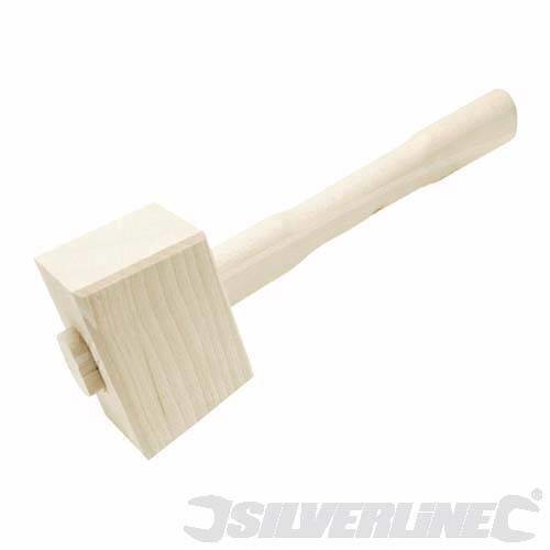

Answer yes then give the gas valve a tap with a wooden hammer
The last one I went to had an open circuit gas valve solenoid.
Needed a V404 !!!
