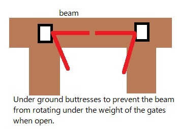

How heavy and what size are the gates ?
It could be that if the gates are heavy then the posts might need more than a simple hole to keep them vertical.
I haven't bought the gates yet but they'd just be bog standard 3m softwood gates. I guess ~50kg? Bernard, what are the brown areas in your drawing? I was planning on just having isolated holes for the posts.
The ground does not drain well (though I'm hoping to improve that - see other recent post!). I guess it's some kind of clay/shale mix.
Adam
The brown areas are concrete just below ground level. It was a single pour ( no joins in the concrete )
The posts had initially been set in simple holes by the company that installed the gates.
Within weeks one gate was dragging on the ground due to the post having started to lean.
