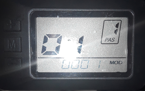

However it showed km/h and clearly would prefer MPH, nothing in the manual to show how to change it, however some playing and I found pressing up/down at same time goes into a menu, mods.jpg and there are 17 settings, the km/h to MPH was clear as number 2, but the rest were just numbers.
An internet hunt found USA sites where they seemed to know what they all are, and it seems similar but not the same as mine, there is no ID number on the display IMG_0008_1a.jpg so can't hunt for identical model. Seems in USA allowed up to 750 watt on the road, maximum speed of 20 MPH but in UK 250 watt and 16 MPH, and it seems mine is set to 350 watt so needs to be set to 250 watt to be legal. Also needs to be set to pedal assist only, at the moment it is both pedal assist and twist grip.
It seems likely below is the way mine is set, hence I say possible as not tested, but some of the values don't seem to make sense, 350 watt at 48 volt is 7.3 amp, but where I think is amps it says 12, if it said 7.3 then dropping to 6.2 would make sense.
Also it says speed limit if sensor fitted, can't see one unless built into motor.
So I am loathed to play in case I damage some thing. So wonder if anyone has already played with the settings and what was the result?

Technically if the bike does not follow the rules it is not an e-bike, it is a motor bike or moped. So needs rear number plates and registering, and a licence to ride it. I was unaware it was 350 watt when I bought it, it was advertised as an e-bike. Selecting mode 1 there are 0 - 5 to select from, it seems the assistance only comes in up to 4 MPH, so keeping it in one of the low modes I am sure both legal and and the battery will last, and it does what I want, it means not used as a push bike, I can ride it up most of the hills, but would be nice to know what all the settings do.

That's odd? It is CE marked?! You're right, 250W is the maximum for an EU (UK) approved bike. Also, I'd be a bit surprised if it's an American bike but all the units in its setup are metric? What make is it? I take it there isn't a forum for users of that make of bike that you can ask the question on? Also, I wonder if one of those settings is for torque? Although the power of an e-bike is capped at 250W over here, as you say, there's no limit on torque. That varies enormously. Mrs Avocet has a (European) e-bike which is maxxed-out at 250W, but has three settings to control the torque. 40Nm is the most it will manage, but there are e-mountain bikes on the market with double that. What this means, is that the bike can help you up steep hills much better. The problem is the legal 250W cap, and as power = torque x RPM, if you keep the power the same and increase the torque, the RPM (AKA speed) has to go down. This leads to quite complex algorithms in the control unit so that at (say) 5 MPH, grinding your way up a steep hill, it can give you loads of torque to help you up there, without exceeding its 250W cap. However, at (say) 15 MPH, it has to limit the torque that it is providing, to avoid going over the 250Watt cap.

What seems odd is the ability to change things without a tool, the mobility scooter and wife's e-bike need a PC plugging in to alter things. So the user has no option, but with my bike I can swap between pedal assist only and motor assist only, and both by simply pressing both the up and down buttons together.
