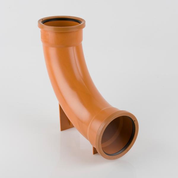

I also have a shallow drain and wish to add a soil pipe (Brett Martin Cascade). The maximum depth of the rest bend invert is 13" (330mm) below ground level. Is this enough so that all of the rest bend is below the surface?
I haven't found a detailed enough drawing of a rest bend anywhere.

Google not working down there? Bless. http://www.knowlesdrainage.co.uk/pr...oryID=11&subcategoryID=18&parentproductID=954
Answer is yes you've got enough depth but you'll need 50mm concrete top cover for the pipe

I did find that drawing, thanks, but concluded it was not the right thing.
Here's the Brett Martin B4131 rest bend:
