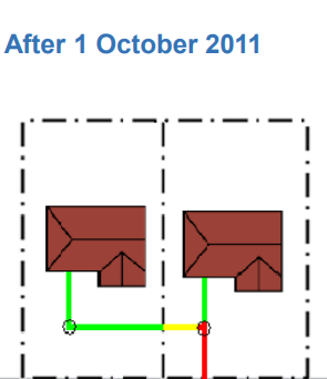

This following diagram is from Ofwat. It shows that as soon as your neighbour's drain joins yours (or vice versa), it becomes a public sewer (coloured red). It doesn't matter that it then passes over somebody else's land. Do they understand that the drains have already joined? There are a few very rare exceptions to all these rules, but the water company should explain if you are within one of those exceptions. Because the standard legal position is that they are responsible. Many people are in exactly the same situation as you and their sewers are covered by the water company.
I think the most obvious answer is that the water company just don't realise that the drains have joined.

So, I've done a mystery shopper exercise with Northumbrian Water blockage team. I said I was ringing on behalf of my uncle and described this exact situation. As soon as I mentioned that the neighbour's drain joined my uncle's drain on my uncles land, the (very nice) man told me that meant it would normally become the water company's responsibility. I stressed that the blockage was actually under somebody else's garden and that my uncle's drain did not join that persons drain. I was told it didn't matter.
I was pleasantly surprised. They seemed to understand the law and all the terminology and the difference between private drains, lateral drains and sewers. They did not seem to be trying to dodge their obligations.
He said they have plans for most of the area showing the layout of customer's drains and whether they are private or the responsibility of Northumbrian Water. One explanation could be that the plan they have for the OP is simply wrong and it doesn't show the drains joining. Or this might be one of the rare exceptions where the water company does not actually take over responsibility. I would plump for the former.
