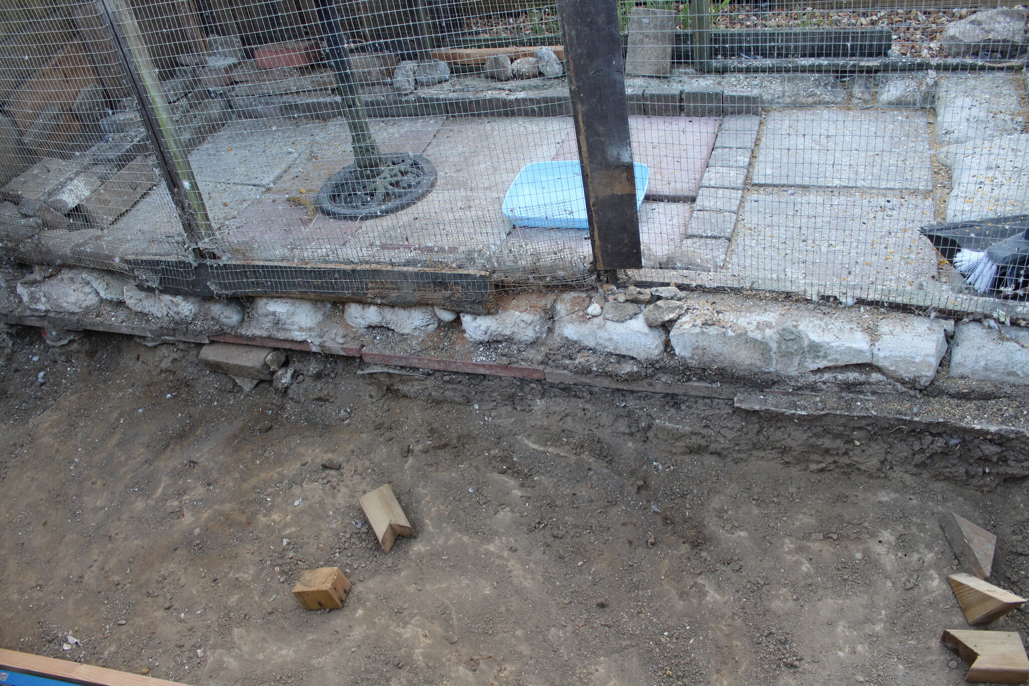

Hi,
Just looking for a bit of advice / guidance.

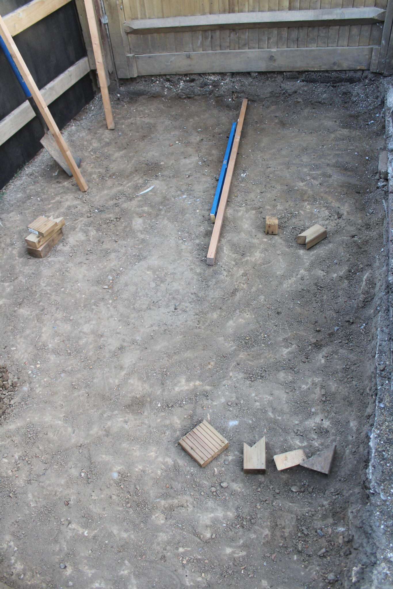

I'm build a new shed and aviary. The old shed has already gone and I've doug out ready for the new base. My original plan was to reuse the old slabs for the base to save money. I've done some working out today and I'm really not sure it will be! It's about 3m X 2m so I'll need 2x bags of MOT (wickes £135 + £35 delivery) then a bag of sharp sand plus 7 bags of cement (roughly). Would it be just as easy and maybe cheaper to get some free hardcore off FB then I'll just need 1X ballast £100 inc. delivery & 8 bags cement?
I'm also assuming concrete is stronger/better and is more likely to be OK in 15-20 years?

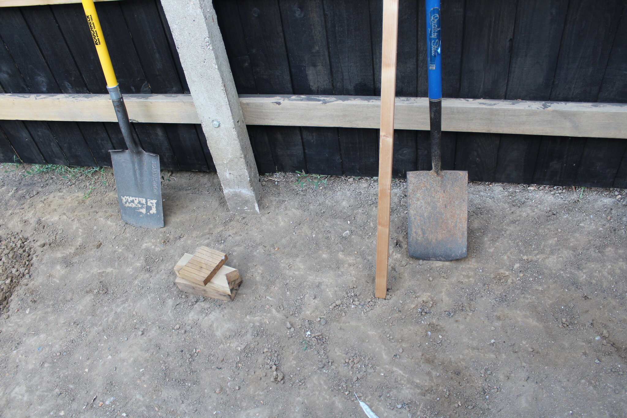

One other thing as you see the area backs onto my fence so I need a small retaining wall, would it be OK to use paving slabs on there ends? they are 16" by 16" so I was going to bury half of them in the ground on a mortar base?
Thanks in advance

Yeah use paving for edgers.
SBR and cement to make a slurry if you want concrete to stick better
You could use concrete and polished off for smooth surface. Then seal
Your base area is 3m × 2m = 6m², so it helps to separate the sub-base and concrete calculations.
If the chosen construction requires 100mm of compacted MOT Type 1, that is 0.60m³. Using 2.2 tonnes/m³ as a planning density gives about 1.32 tonnes before allowance, or about 1.39 tonnes with 5% added. Two 800–850kg bulk bags are therefore in the right general range, although the merchant’s actual bag weight and material density should be used.
A 100mm concrete slab over the same area is also 0.60m³, or 0.63m³ with 5% allowance. At 75mm it would be 0.45m³, or roughly 0.47m³ with allowance. Those are quantity examples rather than a recommendation on the correct construction depth.
One bulk bag of ballast plus eight cement bags is unlikely to produce 0.63m³ of finished concrete, so check the supplier’s stated yield rather than relying on bag weight.
1 to 4 is way too rich. 1 to 6 or even 1 to 8 for this sort of job.
If you can get a hold of a couple pals I'd be tempted just to get a concrete lorry in, volumetric mixer. They'll make up what you need so you don't need to get rid of an overcalculation. Minimum order is normally a cube which is about £300 depending. Wouldn't even bother with subbase ground looks solid, shutter and screed
