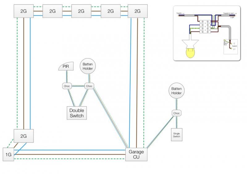

Hi, as it's just a shed I'm going to wire it up myself for the challenge and the cost saving then have someone check it for me when they connect the Garage Consumer Unit to my main one. I've put together a diagram of what I intend to do, here (light connection picture taken from this forum)
I have some questions I'd appreciate help on though please:
- can I run two seperate light circuits as shown but connect them to the same breaker in the Consumer Unit or is this a bad idea?
- does the PIR floodlight need a fuse added inline like it'd have if wired to a socket? If so how do I do this?
- 2.5mm twin core and earth for the sockets; can I use the same for the light circuits too or should I go 1.0mm or 1.5mm?
- the plastic back boxes of the light switches have no metal earth connection point, is this OK and therefore just no need to connect an earth wire to the box?
- any other comments?
Edit:
- also is it ok to run it through and behind Celotex PIR 50mm insulation boards?
- can I seal it into the insulation boards using expanding foam like a grommet when I poke the cable through for access?

Eric makes some good points. You've drawn a lot of sockets, is this because you intend to run lots of items, or just because you would like lots of outlets available in different parts of the shed?
To answer some of your specific questions:
Thats fine, and is no different to what exists in your house. As eric mentioned, DP switching is probably a good idea for the outdoor light.
Probably not, but you'd need to check the MI's for the PIR.
1.0mm or 1.5mm is fine for the lights, but nothing stopping you using 2.5mm (bar the extra cost of the copper). It may be a little more difficult to terminate the bigger 2.5mm cable in the fittings.
Yes, just put the earth into a choc block, or if the faceplates are metal, connect the earth to them instead.
Yes, but derating factors will apply to the cable. You need to be sure that the derated cable can carry the design current.
Not sure, some products will react with the PVC insulation, but i dont know about expanding foam.
I would also suggest that for your lighting circuits, dont use chocblocks randomly dangling round the place. Make all the terminations either at the light rose, or at the switch.
You've also not mentioned how you plan to supply the shed. This is likely more important and more tricky than the internal shed wiring.

Thanks for the replies everyone, some key points I need to update then!
- the supply to the shed will be SWA cable from a dedicated MCB in the main house Consumer Unit. This will be done by a qualified sparky so I don't fry myself. It will hook up to a Garage Consumer Unit in the shed with 2 x breaker (or 3, cannot remember)
- the use of the 'shed' is a small office (6' x 8') hence the proliferation of plug sockets. Running off these will be two computers, two monitors, printer, hard drive, network switch, phone charger and other fairly low power devices
- I intend to run the 2.5mm cable un-ducted in the 25mm air gap between the T&G shed wall and the Celotex insulation. To then get it out to the sockets I intend to basically poke it through the Celotex, through the OSB2 board that will be lining the shed and then into the relevant socket/light
- I did a ring design as I am a complete novice so just researched and came to the conclusion ring was best. Due to the small size of the shed the extra cable cost isn't an issue so if ring is best then I'll do it, if not then please shout
- the PIR will run off a 2-Gang light switch, one gang for the main internal light and one to the PIR; so cutting power is a flick of a switch. Not sure why the PIR would need a fuse but my other PIR runs off a flex with a fused plug on the end so thought I'd better check
- In all of the above I forgot to add a heater to the design. I want to add an electric or oil filled heater running either off one of the sockets in the shed or a dedicated supply form the Garage Consumer Unit
