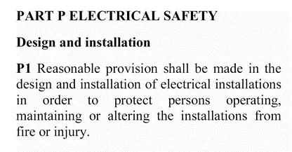

Is it just a case of 'don't eff about with the household consumer unit (installing a new circuit) and with anything in a bathroom' like I keep seeing as the basic guide, or are there specific regulations governing outbuildings in the part p framework? I'm confident I can do the work myself to a very good standard so don't want to end up forking over half a months wages to a spark to do if I don't need the piece of paper that he comes with.

This is Part P:

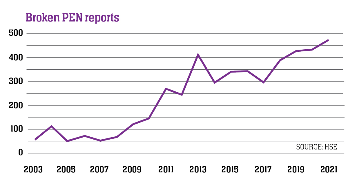

@flameport is correct for England, the actual law says very little. @EFLImpudence and @Notch7 are also correct, however personally I feel just saying not a DIY job is not really helpful, as to be frank it does not seem that hard of a job, until you start reading acticials like this one, do note rather old there have been rule changes since then. The material the shed is made of matters on broken PEN is one of the considerations when putting a supply into an outbuilding, and the problem is getting worse
With a wooden shed it is unlikely to present a problem, with a steel shed it will. Note in Wales it would be a notifiable job, but personally could not care less about the law, more concerned about your safety.
