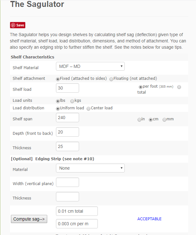

I am looking to make a shelf to span a 2.4m window supported each side on wooden Corbels. Shelf will be 20 cm wide. Would 25mm mdf be rigid enough or would i need something thicker.
Personally I'd rather go for something like 38mm (1-1/2in) or thicker softwood for the corbels and 25mm or thicker softwood for the shelf. At 2.4 metres, though that shelf will need a fair amount of additional support such as sitting on top of an architrave or using inverted angle brackets (if needs be recessed into the underside of the shelf and buried beneath the plaster to the rear of the shelf). If you'd like to see for yourself how much saw there is in a shelf like that (without intermediate support) then key the figures into the Sagulator

I was thinking maybe a bracket mid span on top. The bottom is not possible as shelf will be running along top of window opening. Might need to look at some planed 50mm timber. My Corbels are 300mm high x 200mm projection x 94mm wide. The Sagulator says 25mm MDF on that span and depth ACCEPTABLE

But you've typed in 25 centimetres for the thickness, change it to 2.5 and try again.
Oh yeah! OK back to the drawing board lol Although shelf load will be negligible just a few decorative items (glass)
