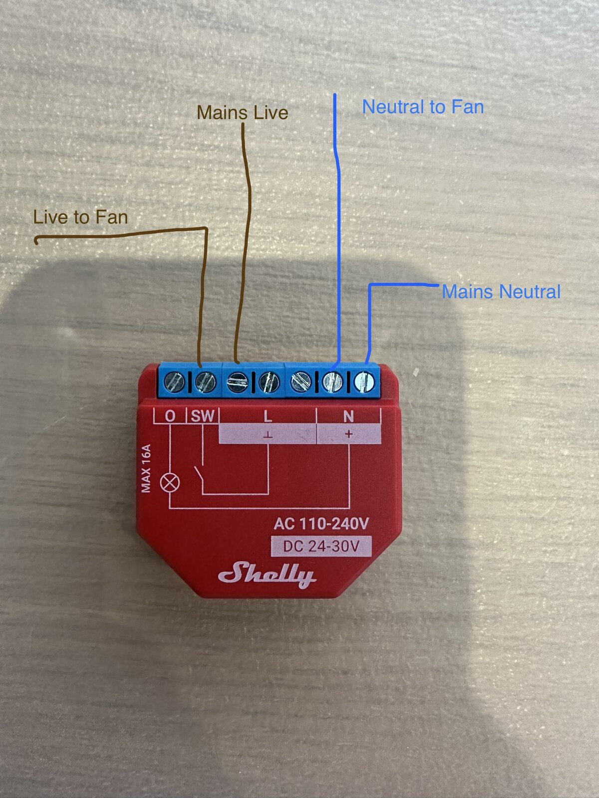

Hi
Have bought a Shelly 1PM to control an in-line bathroom fan - am by no means an electrician but have experience in the past with wiring plugs / light fixtures etc!
Just want to insure I have the right idea for the wiring - have attached a diagram of what I believe should be just after some confirmation from someone else that what am planning to do is correct!
Many thanks
Marc
It's a while since I saw one of these, but I seem to remember that it was a bit confusing in that the diagram printed on it is showing the external equipment connected to it & not what is going on inside.
In which case the external wiring would be as below, except you want to connect a fan instead of the lamp to the 'O' (Output terminal) I'm not sure if you actually need the manual switch either. Maybe it will work without it, or perhaps you would need to insert a link between L and SW if the switch isn't fitted. Do the instructions not provide this information?
