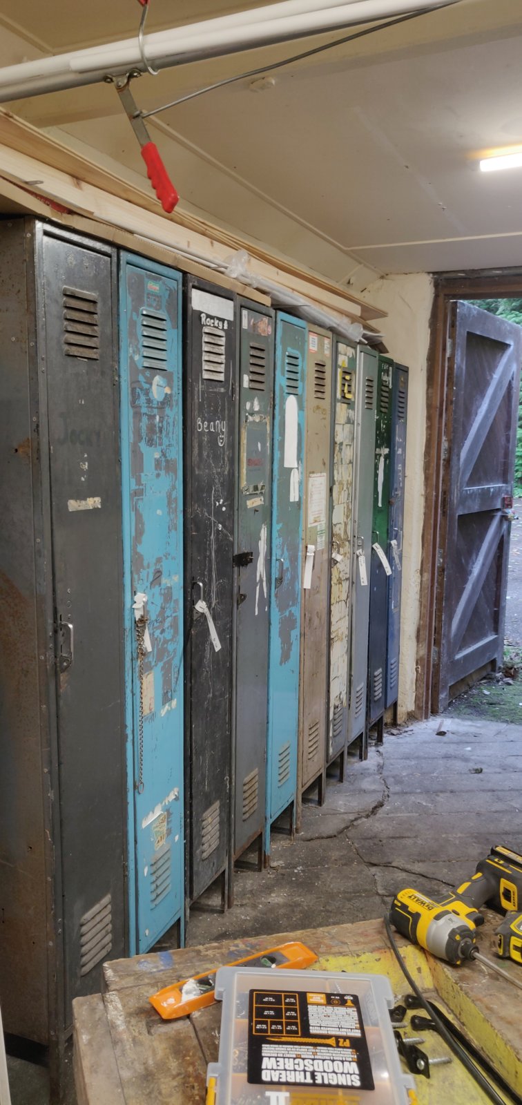

I just bought 10 genuine school lockers like you see particularly in American TV shows. External dimensions about 80"x12x12. Good nick generally except for interior shelves, but if like to redo those anyway for storage in my garage.
They originally utilise small bolts through the side and a mixture of wooden and metal shelves, but I can't think the names of materials I'd buy or where from.
I'd guess I want some kind of 90 degree metal fittings, either small brackets or extruded L shape I can put shelves on top of... But probably only 10mm wide and 1-2mm thick. Almost like old Meccano!
And shelving either sheet metal or just buy some ply.
I'm in the situation I don't know the names to Google for... Can you help me?
no8 x3/4"[4mmx 20mm ]twin or chisel point wood screws 2x1" [21x43mm]baton screw through the outside into the baton no pilot needed as the point will pierce the metal after 5-10 seconds
