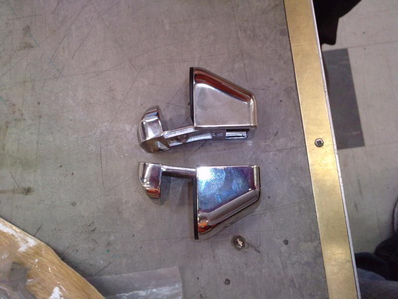

I acctually used them clip the hold a shelf up below my TV.
used the biggest screw that fitted nice and long to ensure they got good "bite"
But the clips actually opened up where they slide together causing the shelf to fail down causing minor damage to ubit below but failing PS3 did smash my laptop
My email got a bit sarcky said:
I can provide a picture that shows the shelf in use to ensure it was as specified ( one of B&Q kits) Before PS3 was put on shelf at Christmas. PS3 wieghs 3.2kg Vplus weighs about the same. so well below the specified weight tolerance.
The correct screws where used. I used the the Grey Rawlplug 10mm size with a 50mm long screw 6mm ish in diameter to penetrate the plaster into the brickwork.
These where the countersunk type as due to the nature or the clamp no other fixing would be possible without the wooden shelf not locating in the clamp.
The wall was flat over that run of the shelf, Full replaster a few years ago. The replacement shelf has NO noticeable gap over a longer shelf.
If your client felt the clamps where not a fault why was i given a Gift card and a refund on the Item and informed "there was defiantly something wrong with the but we are not sure what, and to make a claim via yourselves"
Your Client is wrong it assumption that these where not fitted correctly, Something I will always do is over engineer the fixing to stop the fixing coming out use as big as possible.
When the shelf failed the fixing where still secure and not failed. In fact they are still in the wall hidden by the replacement shelf.
If your client inspected the fixings correctly They would be aware that a countersunk screw in a counter-bore will leave very little witness marks as the two angles match to provide the some force over a great surface area. If i had use any other fixing such as the bolt type the would be more damage to the mounting face. However with no markings in the holes prehaps i used magic and willpower to hold the shelf up????
B&Q's first and second answer said:
It is of our client's engineer's view that the clips in question wouldn't be able to bend had they have been fitted correctly.
You can see the rear bend but not where they run???? the bootom piece "fell" free and the top was still fixed to the wall square??? and level
Is the bottom part the one with the black rubbery part on?
Did the rawlplug come out slightly when the bracket buckled? I'm asking because from the photo it looks like the screw mounting hole would have moved away from the wall... or did the bottom part dig into the plaster?
Regardless of what their engineer is saying, it's a bit iffy to design a shelf bracket that (presuming the engineer has seen the photo) relies on being mounted against something rigid to maintain its shape. :roll: :roll:
I always thought the weak point of any cantilevered shelf such as that was the friction retaining the shelf in the bracket, not the bracket itself!
the bottom is the rubber bit on.
As it bent it must have dug into the plaster.( but no marks on wallpaper) and the screw where spanner tight still.
I had nipped them up a couple of times but it was not till they failed and "standard" type shelf fitted i realised how far out they had become.
It appear that You could hold the shelf tight after the failure even with that bend. the lower clip had opened out allowing it the pull away from the fixed point
