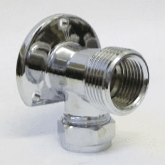

I want to reuse the inlets from the old shower that I am removing - the problem is all the new modern looking bar showers have ridged risers that are too long
They say do not cut- but can I ?

Unfortunately not short enough! But thank you
Then you could use these to lower the bar mixer position...
Use chrome elbows on current pipes and a bit of chrome coated pipe to get bar lower down, giving you the height needed for the riser.
You'll only get 15 or 22mm chrome couplers for the riser so, unless you can get a shower with a riser of that bore, then you're stuck!
Else it's removing tiles and getting feed pipes to dog leg down inside the wall!
