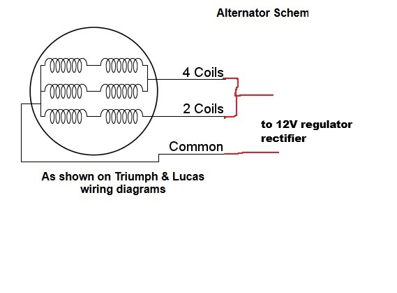

Pls excuse this posting which is somewhat off topic but purposeful to tap into a community without "accepted" bike-lore opinions. I am a stranger to the world of vintage bikes. An uncle who has become recently into nice old British bikes has asked me about wiring and converting alternators from the stock 6V systems to current 12V systems.
A lot of the theory appears to involve bunching the 3 phases coming out of the alternator together into one conductor and then feeding that lot to a rectifier/regulator unit....., against the "Common" point from the alternator (which I guess is the centre of a star wound coil arrangement) - as shown here:
present "modification" advice being as I have indicated with red pen. This strikes me as "Not Right" because it basically appears to short the 3 phases at the alternator. My limited practical experience of alternators is with small simple chinese wind-turbines, where the mfg-advised method of "braking" the fan is to short the 3 phases, which kills the output and puts max load on the fan in an attempt to stop it. If the wind power overloads this torque then the alternator cooks up, presumably because ALL the current from the peaking winding gets forced through its neighbours, many times a second.
perhaps I am missing nuance in the way that an alternator can be arranged?

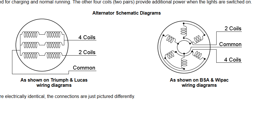

there are stock drawings from the original bike manuals that indicate sets of coils can be shorted together, see here:
None of this seems right to me but I must be missing something. I just wondered whether the original stock "kludge" of shorting together the 2 pairs of windings was a known trick, then latterly the biking community has (with some ignorance?) blindly extended that trick to shorting all 3 coils together?
I must be misunderstanding sthgh because if this was genuinely an error there would be fried alternators all over the place.

Each flywheel generator seemed to have its own wiring, I remember back in the 70s trying to convert to 12 volt, and to add extras to the system, and it not only depends on the coil arrangement but also the magnets, there was basic no standard between motor bikes.
The one I had there were 5 coils, the sixth place had the contact breaker for the ignition, and each coil had different gauge wire, and different number of turns, so one coil for side lights, two coils for headlights, one coil for stop lights, one for the horn, and one for ignition.
But another bike had 6 coils, and a magneto, as you show here, 1785751200136.png with the common not using the frame, we would take the common to the centre of the two batteries, and half wave pos to one battery and neg to the other, and a zenor diode across the battery to stop over charging.

I guess in essence I am wondering in what situation it is "good practice" to short the coils on a generator?
I seem to be thinking of it as short-circuiting a current source: one would never join together 2 of the three phases at a 400V mains supply just to get a higher current for a singlephase purpose.

Shorting out a winding may be OK, as at zero volts it may be also zero amps, but it would depend on internal resistance of the coils, and there is no real way to know. A lot depends on cooling as well.

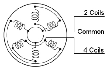

The method used in old British motorbikes was to use a coil for each job. Often each coil had a different gauge of wire. But some did charge a battery, often 6 volts, and it was really a bit of hit-and-miss, and it was a regular job to put the battery on charge.
So the headlight switch as well as turning on the headlight, would switch in or out more or less coils.
If the coils at 60º to each other, and you have two magnets, you would get three-phase, however often there were many more magnets, so the coil outputs could be in phase with each other.

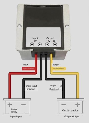

There are battery to battery chargers, Sterling do one for narrow boats, designed to charge a battery in the bow for the bow thruster, but one it is 12 volt to 12 volt, and two in a narrow boat weight does not really matter.
So as it stands, I do not know of a ready built unit to do the job, there is no technical reason not to make one, but a google hunt tells us anything using 6 volt is rare.

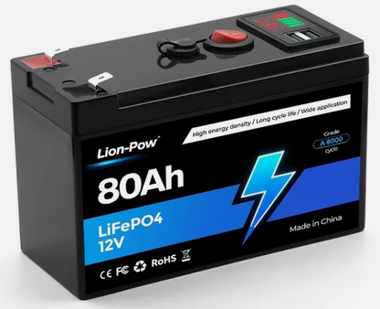

So with a vintage motorcycle, the question has to be, will the effort to convert 6 to 12 volts be worth it? So this 1786971978497.pngweighs 1.5 kg and 80 Ah should last a day with no problem. As to a smaller version now we start to look at the head lamp. There are rules as to using LED head lamp bulbs, and I don't know what they are.

So this View attachment 420592weighs 1.5 kg and 80 Ah
Are you sure 1.5kg is correct?
I'm finding 67Ah at 6.7kg and 100Ah at 10.5kg
I was looking at some on forty thieves but all of their batteries were a factor of 10 out on capacity and price, I was looking at 200,000 mAh which was the size of a 17Ah jel battery, similarly 65,000mAh the size of a 6Ah

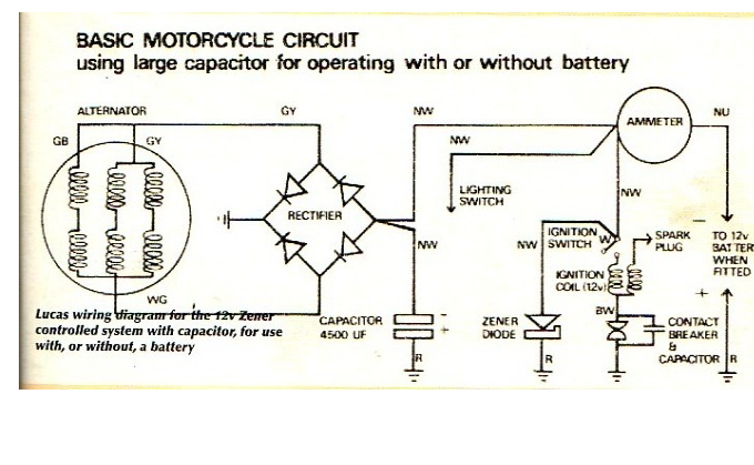

TBH I don't recall much now, but the only times I was involved in the alternator wiring, both were 3 phase - 3 wire.
I do recall that on one, it was a simple shunt regulator (big zener diode) and a permanent magnet on the end of the crankshaft. The headlight switch disconnected one of the wires (so 2 windings) from it's rectifier when off. So with headlight on, used all 3 (or probably, 6) windings, but with headlight off only used 1 which would reduce the power needing to be dumped by the regulator.
